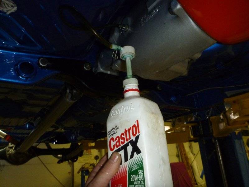

You expect an employee at CTC to know what that is... seriously. Most anything works, just don't put hypoid in it.
