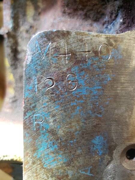

Hello, what's the difference between a 440 R block and a RB block. Is it a good block to do a stoker motor. 500 + HP it's been a while and can't remember. Thanks
440 is a RB. Short for raised block. Or tall deck if you prefer as opposed to the 350 (yes)-400 B or short deck.
Can't say as I have ever heard the term R block.
M could mean Marine and R could mean right hand rotation. I have a marine block with an M and an L, and it was a left hand rotation engine. All stock 440 blocks are RBs.
Can you use the block. I'm going to rebuild anyway.
Why not, it's a 440. Have the machine shop clean, magnaflux, and sonic check. If it's OK build your engine.
I don't know what those stampings mean, never seen anything like it. In any case what is stamped on that pad doesn't really matter if you are doing a full rebuild. Just have the shop check everything over and if it is all good then you are okay. The shop needs to look at all machined surfaces including the size of the lifter bores and the cam bearing bores. Lots of things can be wrong in an old block, especially if you don't know the history of the block.
A might mean 0.020 over, M might mean Marine, R might mean Regular fuel, G might mean 1971. But the numbers and letters are not in the usual order so it could mean something or nothing at all. It could be a stamp by a rebuilder or something else. I wouldn't worry about it, just have the shop check the block and go from there.
I'm going have a machine shop look at it anyway. I was just curious about the stamping on the block. Thanks
Basically a 440 is a 440. The year doesn't matter much. The ribs between the freeze plugs are nice to have. Take a good look at the front of the block, see how close to the center of the castings are the bolt holes, look at the lifter bores, how centered are they. Sonic check the cylinder wall thickness if you can. Most any 440 block is adequate for a moderate HP build. If you are going for full bore power you need a thick cylinder wall block. Sonic testing will verify that.
After losing a cam due to improper lifter bore machining I will always have my blocks checked for lifter bore alignment. I believe BHJ makes the tooling.
