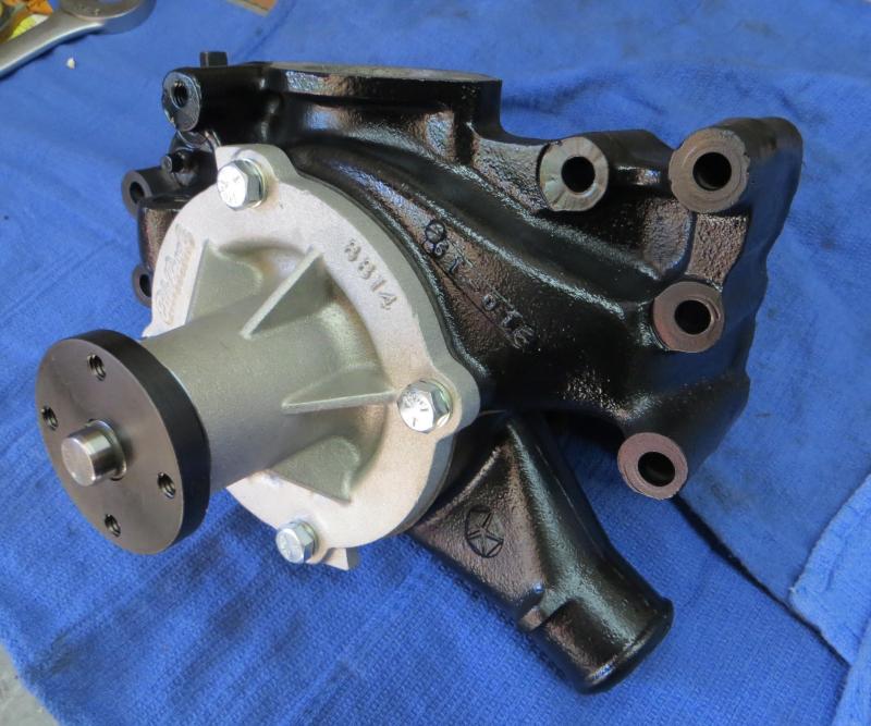

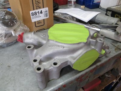

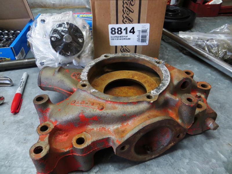

So after some help and research I'm going to go with the original pump housing with an Edelbrock pump.
See how it came out :)

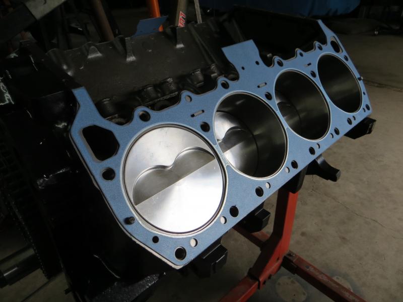

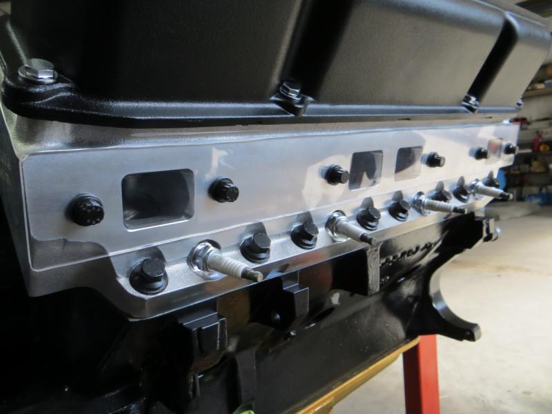

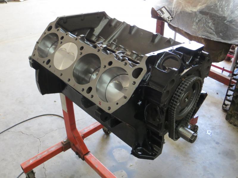

Long block and Heads on
Long block all done!
(I Plastigaged the crank and checked and filed the rings, which toke a long time)

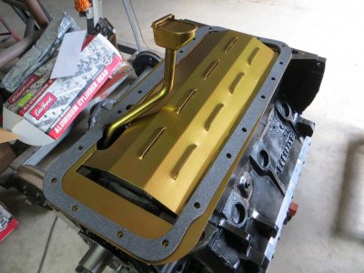

Also tested the oil pan and windage tray fit.
Heads are on, and now onto the timing and cam gear.

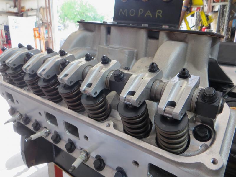

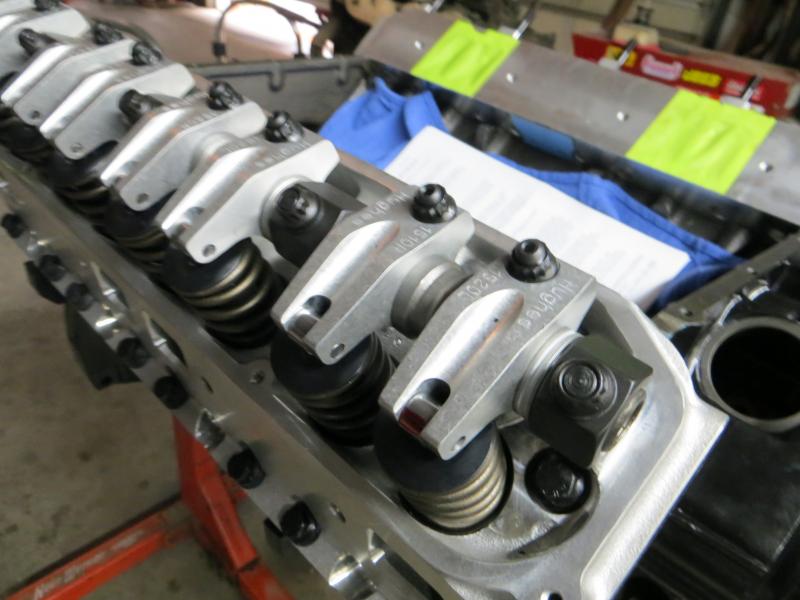

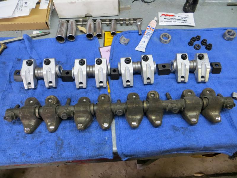

Setting up the Rockers (complete with hold down kit)

How did your Hughes hold down kit go? Have read that they are short on spacers and you have to supply your own...lots of them.
What pistons are you using?
The valve train came up good. A lot of time spent on adjusting it up and getting it spot on (not like doing a chevy 350). The hold down kit is made very good and looks strong. I did use all of the large spacers (which hughes said was normal) I used a couple of the 20 and 40 thou shims here and there but had plenty left over.
have a look in the next photos.
Setting up the valve train. A bit of an upgrade!

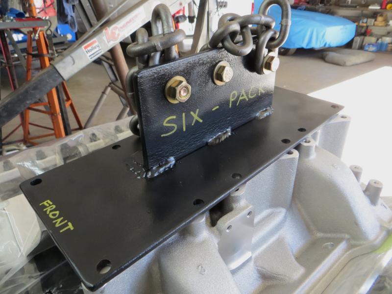

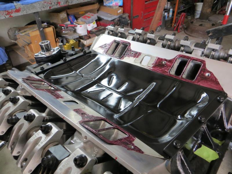

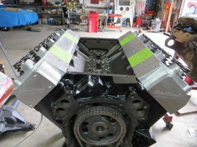

custom lift plate
Had some time wile waiting for hughes engines to make up the push rods for the engine so i made a lift plate that will work on the six pack manifold.
Also got the all the soldiers lined up!

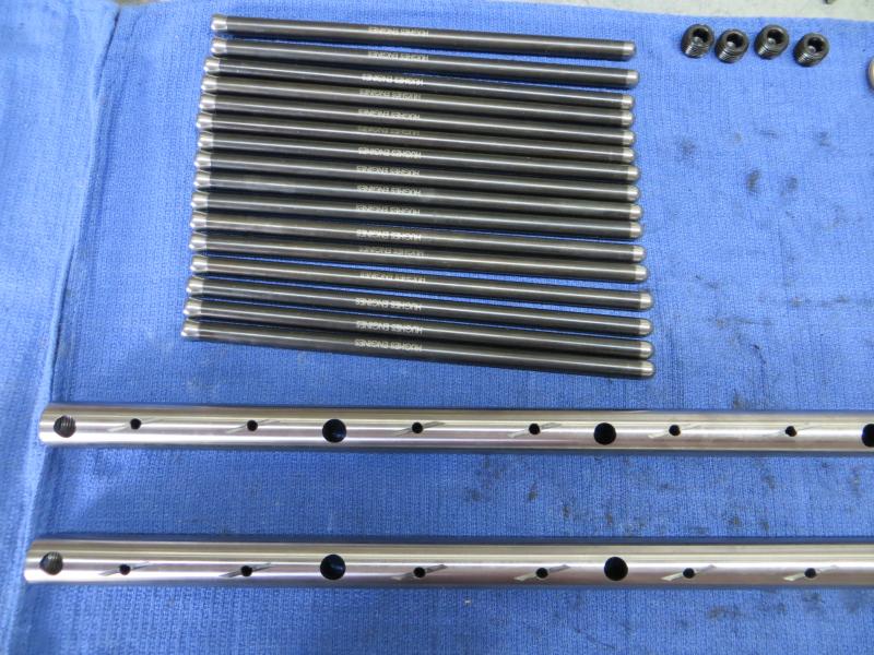

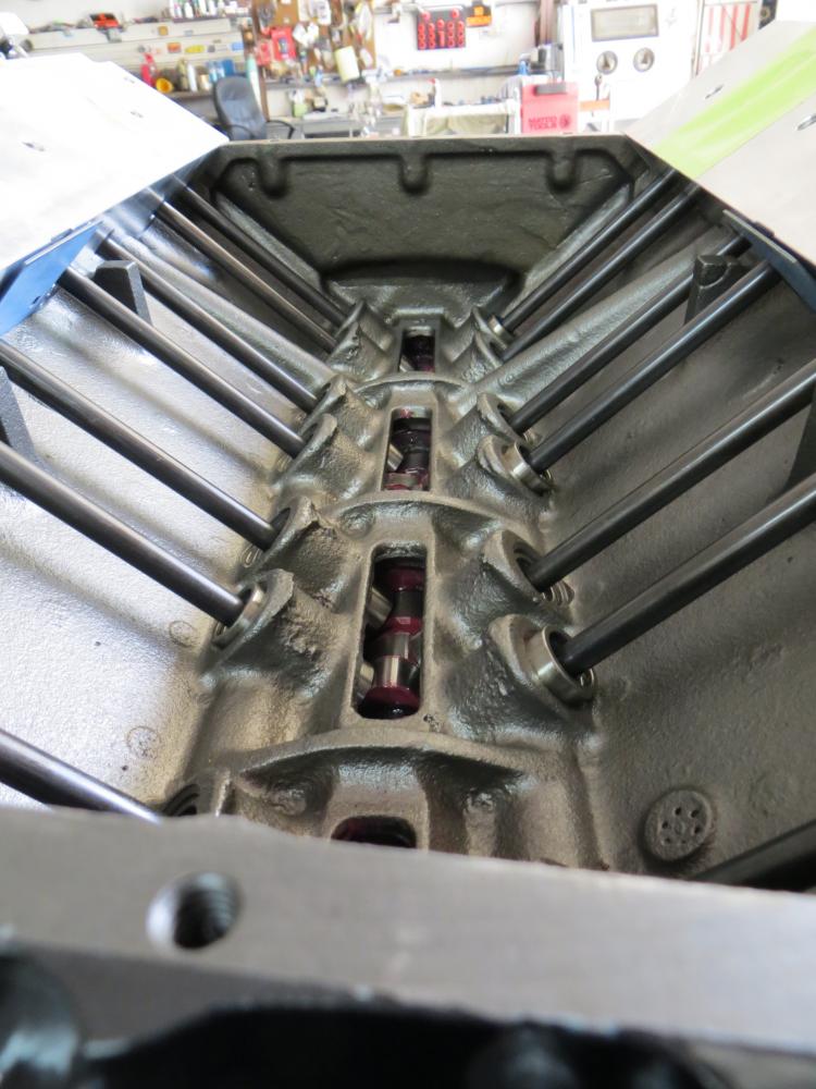

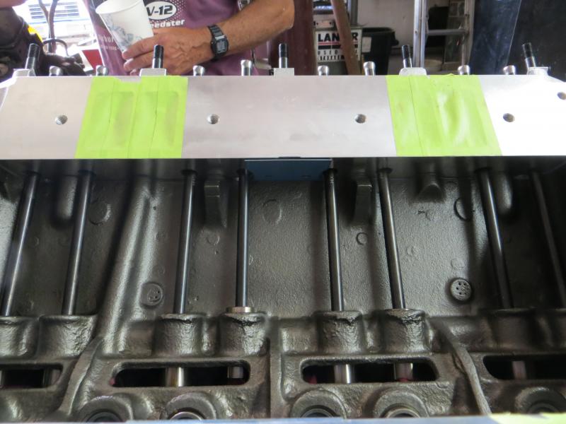

Push rods here and going in!
Also made a cover to go over the exhaust holes

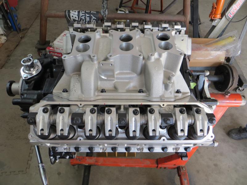

manifold on

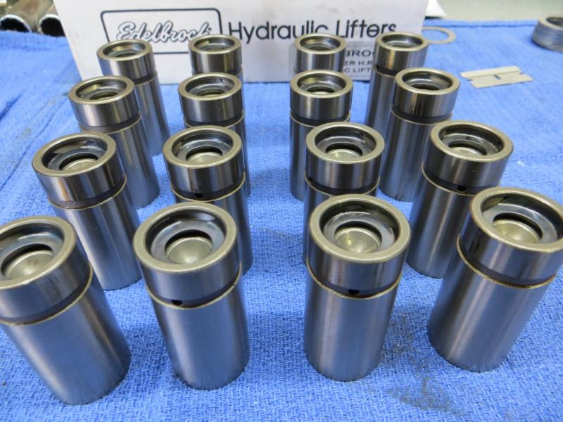

You did put plenty of break in lube on that cam, didn't you? The pics make it look dry...
Not meant to offend...just checkin'...
