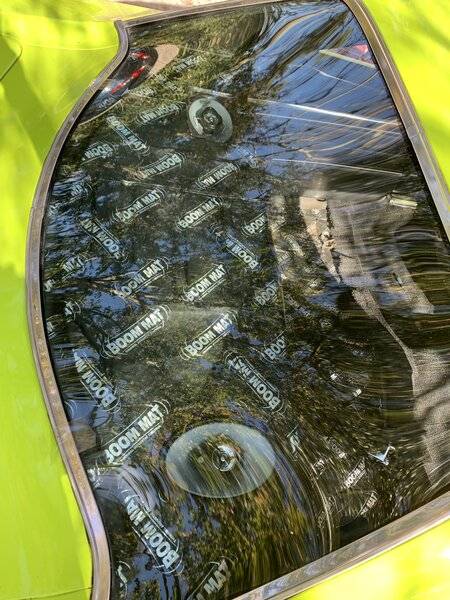

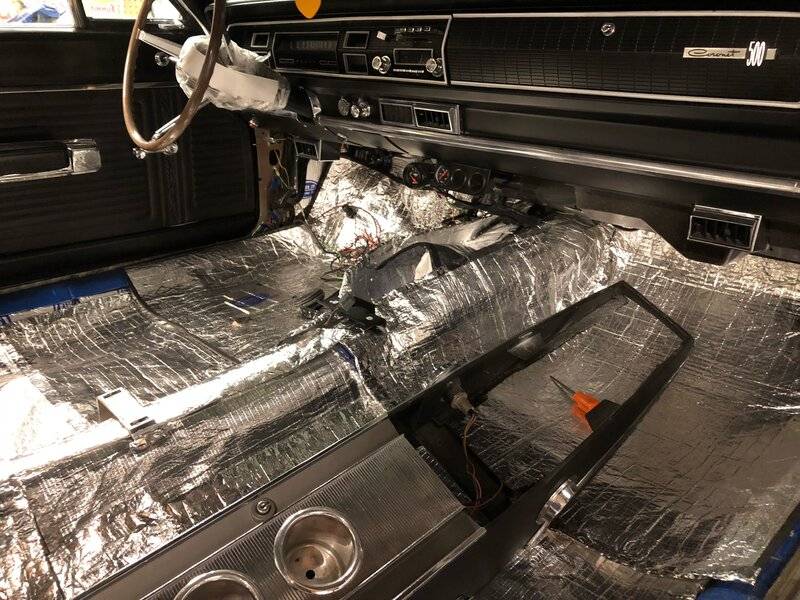

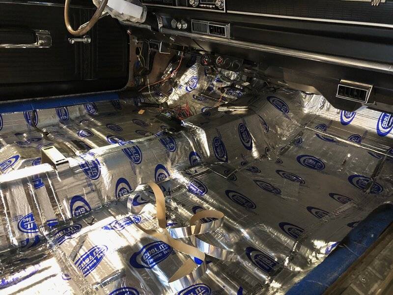

I used boom mat in the trunk, package tray, on the rear seat divider board and under rear seat. What else can I do? Would headers help the droning?

i recommend some heat/sound insulation on top of the boom mat.
my exhaust tips end before the axle and doubling the insul quieted things tremendously.

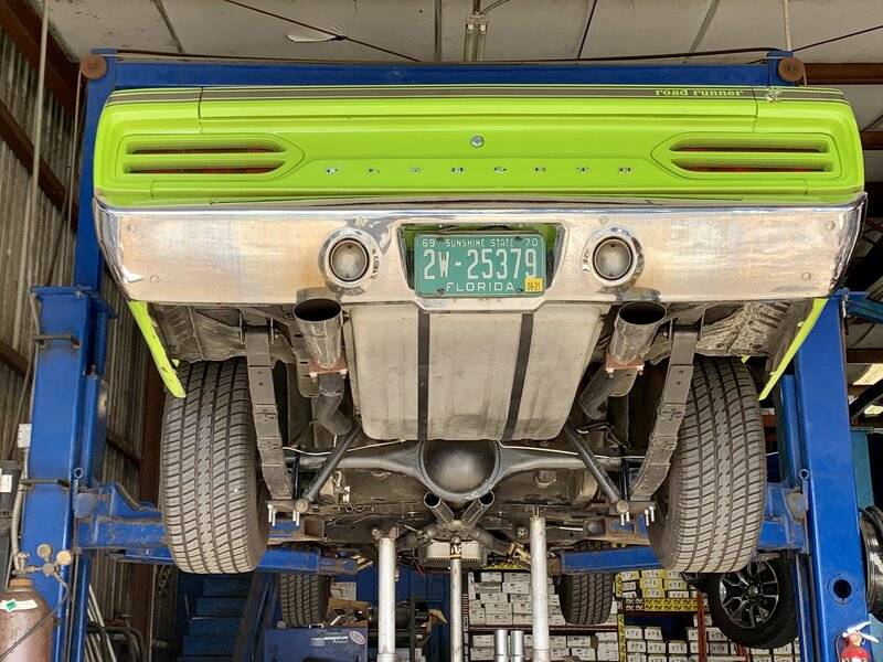

As mentioned, does the exhaust run out all the way out to the rear bumper? If not, you have a large base speaker under your car. Low frequency exhaust pulses will make that baby drown! 440'
Yes it does.
That's exactly where you should add your "resonators". I used Thrush glasspacks. From your tips to where the pipe drops over the axel can be sectioned out, weld in the glasspacks. Done.

i did some big patches on interiors of doors and in the interior of area of the rear roll up windows. also did trunk area too. car is carrying probably 100lbs in insulation alone
