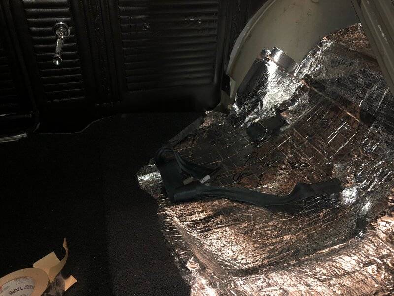

My last car had a bad drone to it. So on this one I put Dynamat everywhere including roof, quarters and doors. Then a layer of Dynaliner in roof and doors. A layer of jute padding on floor, then carpet padding and carpet. It seemed like overkill but inside the car is quiet and cool.

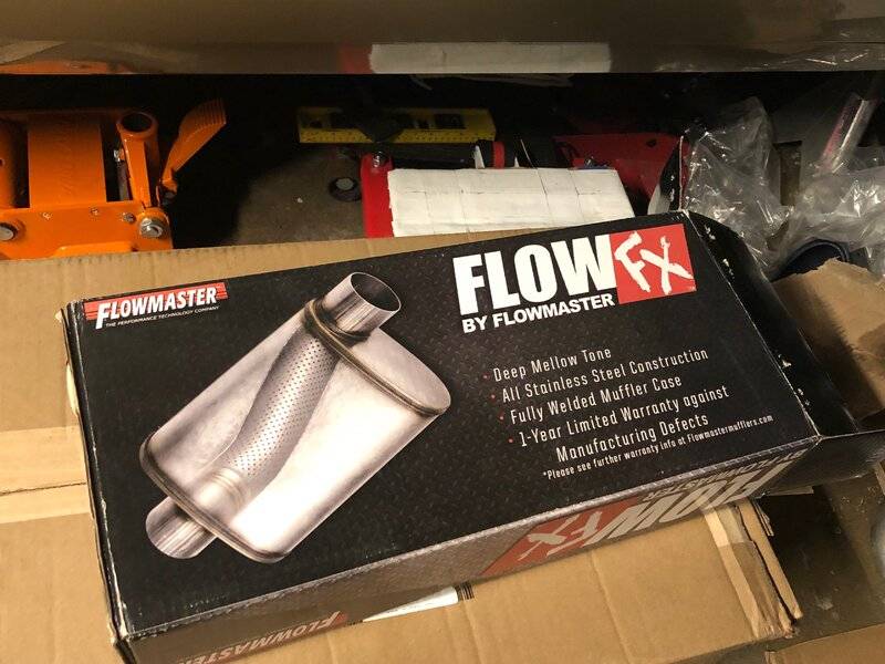

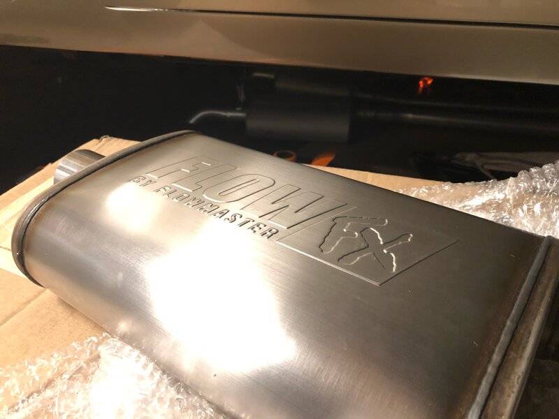

when i built my exhaust setup i switched from flowmaster 44 to the flowmaster flow fx series (material filled) mufflers. they are a straight thru design but have nearly de-droned the car. i was looking to quiet my car down a tad so i could sneak out in the mornings and not ruffle the neighbors. i have stock exhaust manifolds on my 440cu. everything is 2.25”

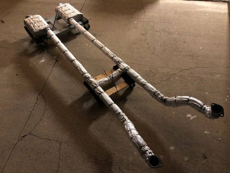

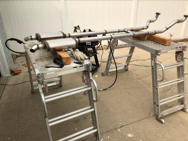

6342374D-C80E-44A8-8513-C96C4120B177.jpeg BAA1A026-1B85-404B-9AAD-DB01F97C9E94.jpeg 4B58E5ED-45D8-4617-AC78-2DBE9815207E.jpeg 8D570877-BC8F-47E5-AAC6-E6761D726628.jpeg 963A862B-65BE-4414-8DC3-11569020CE0A.jpeg FF993ADE-9958-445E-B226-F0536F678A28.jpeg

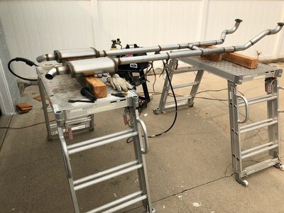

My 68 Sport Satelite Convertible was driving me crazy with the drone when I got it. I have a exhaust shop at my house so changing the exhaust was no big deal. I put on a set of headers, X pipe. big body Dynomax super turbos and used Flowmaster Flow FX mufflers as resonators before the bumper. NO drone what so ever. It is pretty quiet also but that's the way I wanted it. 2 1/2 pipe.

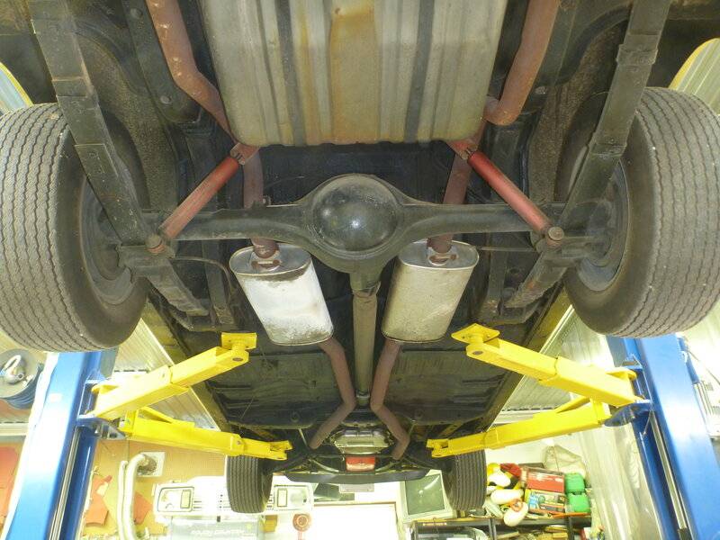

Do you have a pic? How close are they to the fuel tank?
Summit has two resonator options that might solve the problem, by Jones Exhaust. Both are 2.25 inlet/outlet. AR3514b is 14"long case, by 3 1/2 dia, would need to be welded in cause it has no stubs, $17. The other is AR3012S-5, 17"oal, 12"case, 3"dia. This could be clamped in place, it has stubs, $21.

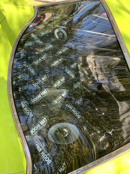

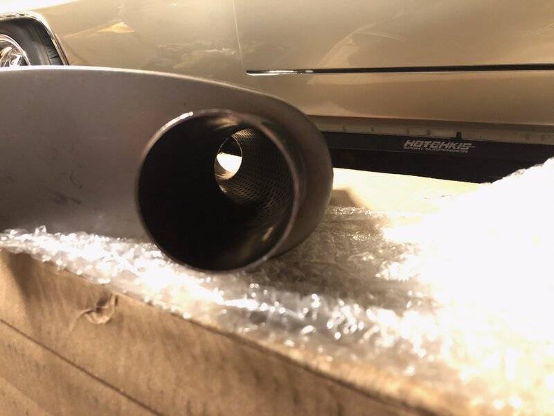

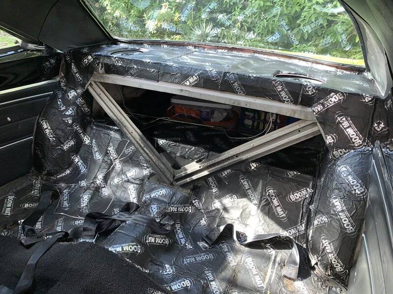

View attachment 1038207 View attachment 1038208 So in the last 6 months I’ve replaced flow masters with magnaflows (flow thru design) and today went with summit racing welded turbo mufflers. No difference in any of the 3 as they drone my brains out from idle to 50mph. Over 50 they are super quiet. I have stock hp manifolds and 2.5” tubing with an X pipe. The X pipe really helped and smoothed out the sound quality but droning is killing me.
I used boom mat in the trunk, package tray, on the rear seat divider board and under rear seat. What else can I do? Would headers help the droning?
