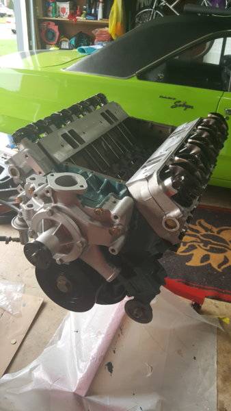

I've been running a 440 source aluminum housing and water pump for roughly 1.5yrs and 4k miles now on my 383 without any issues.... runs nice and cool with my 2 row ECP radiator too ! Here's a build pic ...
