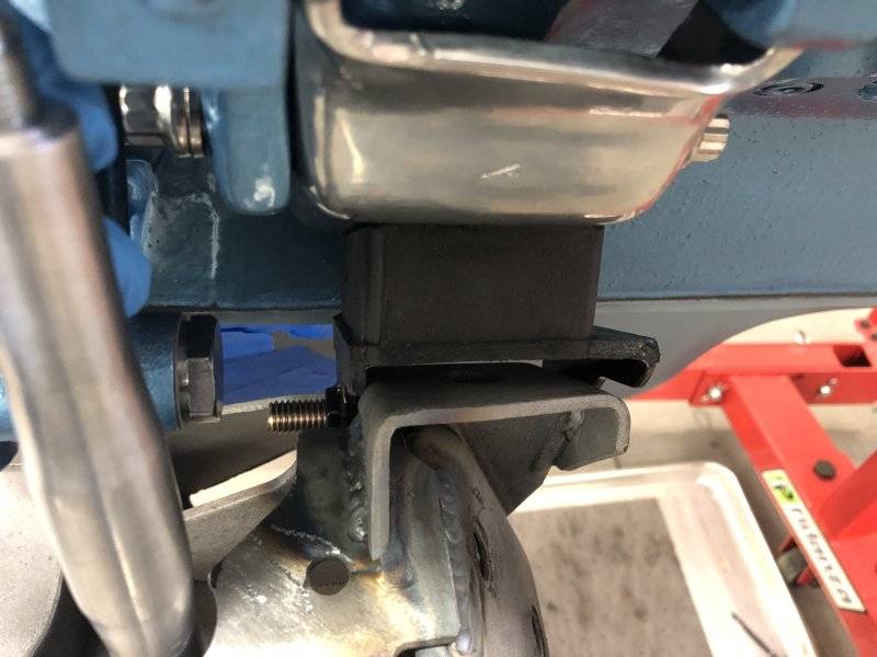

I am currently using these mag mounts. I was curious about the polyurethane to give me a 1/8" or so more clearance (thinking they don't compress like rubber) and limit the engine shaking b/c my #2 header tube was slightly contacting the inner fender. I have shimmed up the mount 1/8" and it seems to be ok now.

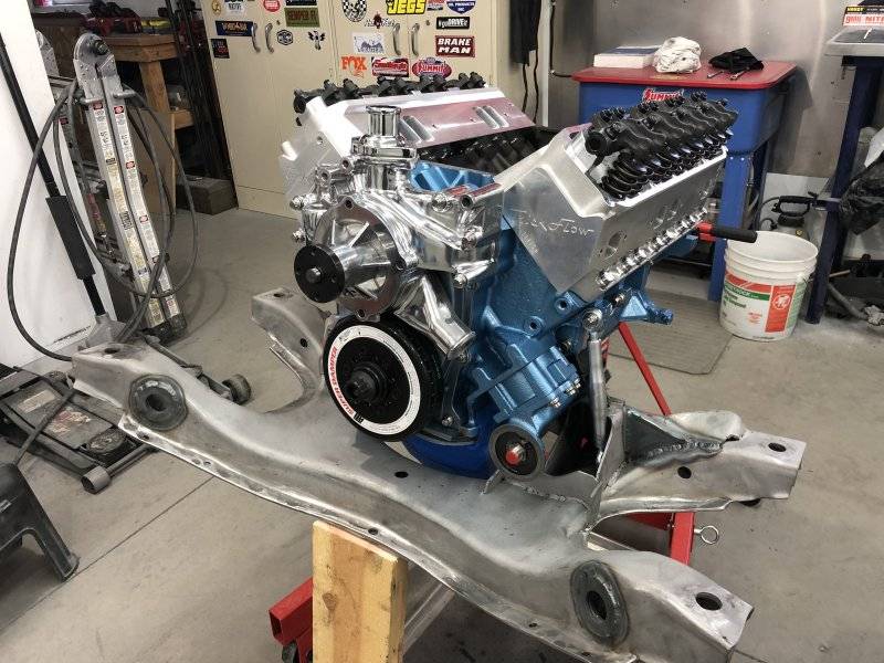

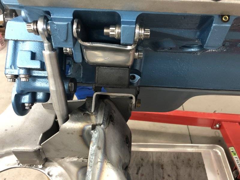

Still tweaking the the torque strap. It's basically a little insurance in case the Mag Mount fails.
Runner 68
Tarnished Bronze Member
1:56 PM
Feb 22, 2013
3,637
4,291
The Red Anvil Dog House
Looks good, might need to make one for mine
Pretty basic really. Just two heim joints and and a radius rod.
I still need to punch the hole in the K Member for the bottom joint. The radius rod I ordered is 6" but a little too long. I'm waiting on a 5.5" replacement so I can center it in that portion of the k-member.
ARP stainless bolts, chromoly heim joints, T6 aluminum swedged radius rod. Hopefully it will stay together under ~650 pounds of torque.
