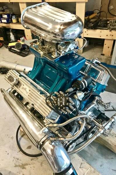

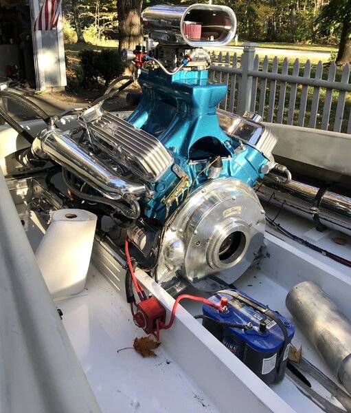

Nothing beats a tunnel ram, if you don't mind a hole in the hood. With the SK resto boats, it's about the cool factor. This is a 438 B block with stealth heads and the XS282S
