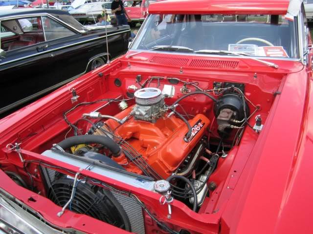

I have NO room for a mechanical fan,have 2 pushers in fron of the rad:tongue7:

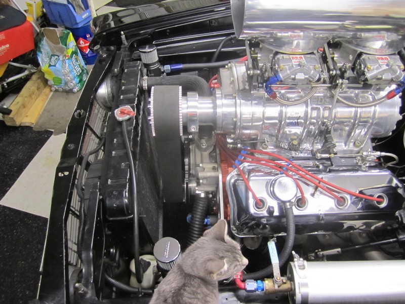

180 Napa Superstat. Green coolant. Shroud. Copper 26" radiator. Clutch fan. Ma knew. Stay with the formula. No electric. No aluminum. Like Volare Roadrunners are not better than 69 1/2 Beasts, newer is not always better. Just sometimes.
I use the stock waterpump on my 493 and a flex type fan. I also have an aluminum rad and a shroud. It cools fine but if I sit in traffic very long on real hot days it will creep up to 200. So I added a pusher fan you can see here and I have it on a toggle switch. That way I only turn it on when I need it for assistance. If I turn it on when it creeps up to 200 to 205 on real hot days sitting at the lite and then it brings it back to 180. It works very good for me. Ron
