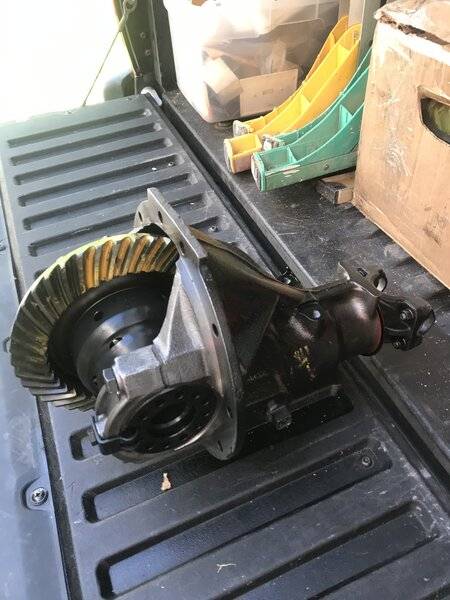

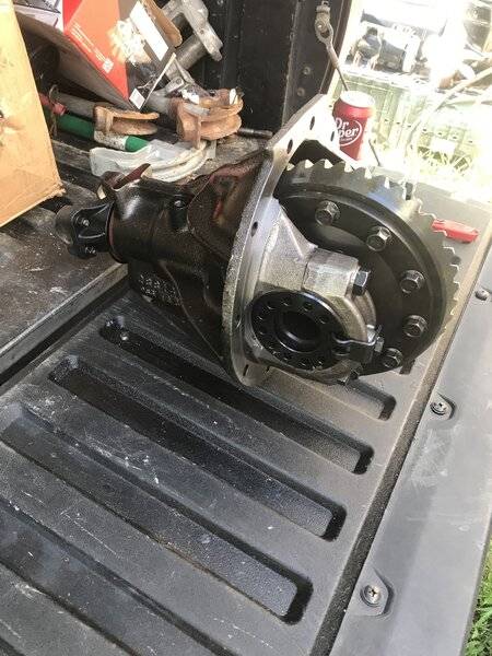

Mike just bought a suretrac setup I will be pulling the 489 out today and installing the new 489 sure trac with 3:23's and a 7290 yoke. Today will be the first time its been on the road in almost 2 years. I mean other than taking it up to put gas in it.

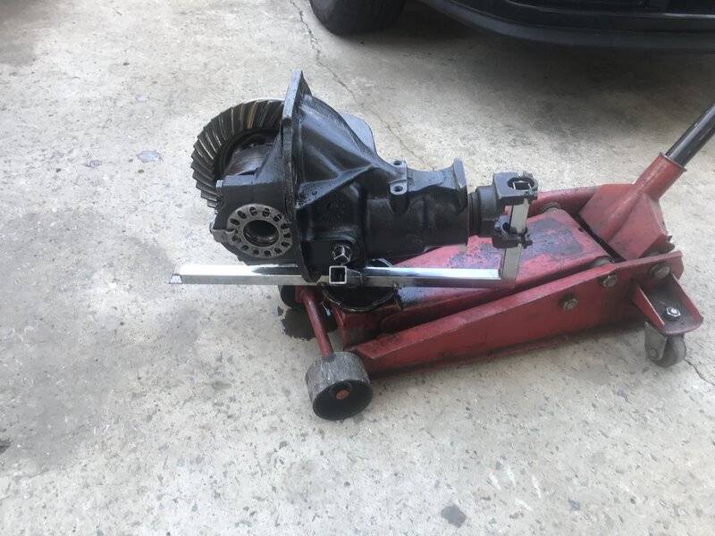

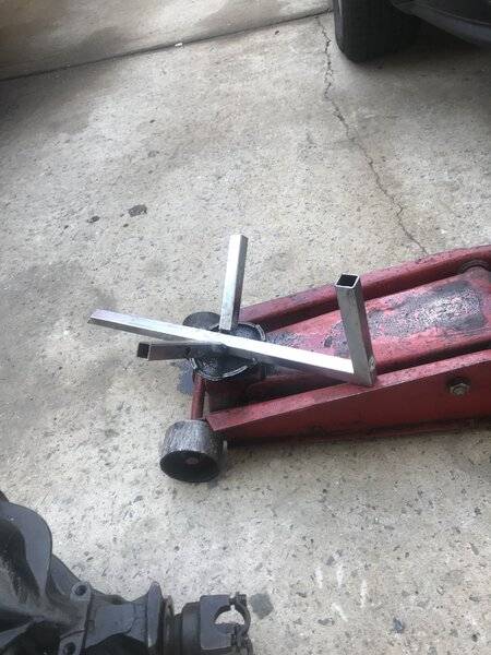

Here are a few pictures of the jack cradle i threw together so I wouldn't have to bench press 80 pounds from the ground. Welded it to my crappy jack with some tack welds. It will come off pretty easy. Sure beats getting your skull crushed.
