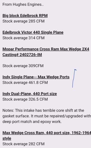

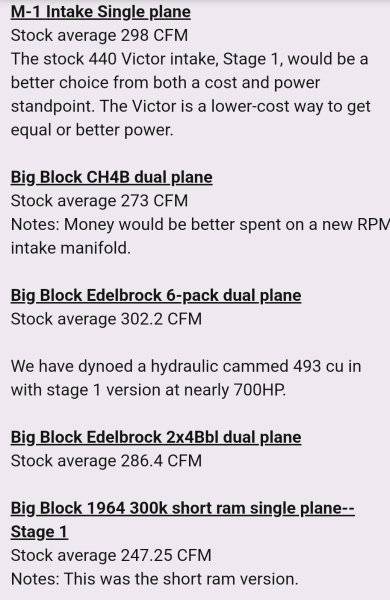

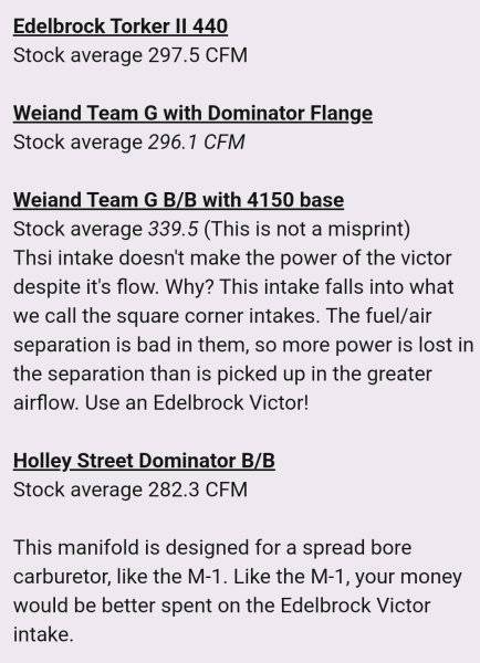

The OP wrote (in Post #8), "I also have no hood clearance issues, as I have an A990 scoop that is taller than stock. I'm looking to achieve good fuel distribution." so he can probably run pretty much any intake that suits him. His primary question was for good fuel distribution. I have a personal preference for a certain intake but have no information on how the fuel distribution is in comparison to other intakes. I seem to remember a magazine 'shoot out' article comparing different intakes but can't recall if it included flow/distribution numbers. Hopefully someone can give the OP the info he is looking for.
This is overall average from hughes..but no dist. Among cylinders is listed. They obviously like the victor. Older list no track heat on here.
