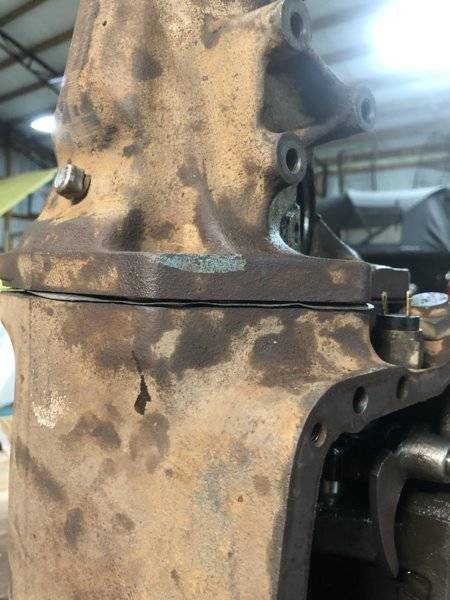

I haven’t pulled it back out to check this time. But every other time they were all good and I was getting the same result. So I’m assuming they’re all still in place. It’s about 1/8” from the cases seating every time.
Here’s the gap
don't tighten the bolts!!! Reach down and spin the input shaft and the synchro between the two shafts will seat
Thats where i was thinking my problem was. It seems to be seated though but again Im new to 4spds so I don't know. I can reach (barely) under the 3-4 slider and move the synchro side to side and it stops when the keys hit the edge of the grooves which is what makes me believe its seated. Im gonna call Brewers in a bit and keep trying. haha and i appreciate the bolt suggestion but Im not willing to try that or hammering. It should fit back like it came out.
The reason I suggested tightening down the bolts (not hammering !!) is because these two parts are a snug fit for alignment purposes. They do not just "slip" together !! If you can move the syncros then things are aligned - snug the bolts down and it will pull together.

Well I’m here under the words of Fred Sanford, “you big dummy”! During one of my previous attempts the 3-4 slider came off. When I put it back together I put the hub in backwards. I thought I was paying attention but apparently not. 100% humidity and 95 temps in south Mississippi take it out of ya lol. Anyway swapped it around and bang, went right in. I appreciate all you guys help and suggestions. But this one was on me, and only the Lord can fix that! Haha haha
