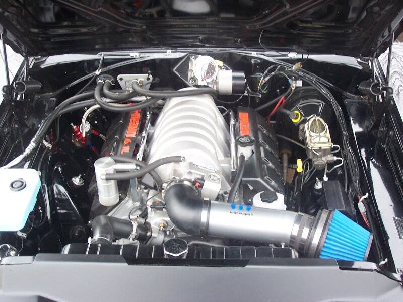

I used an aftermarket cold air intake but it requires a trunk mounted battery. Maybe you have more room on the passenger side.
My battery will be in the trunk as well so that isn't an issue. That looks basically the same as what i have on my 2010 Challenger. Its one option for sure.

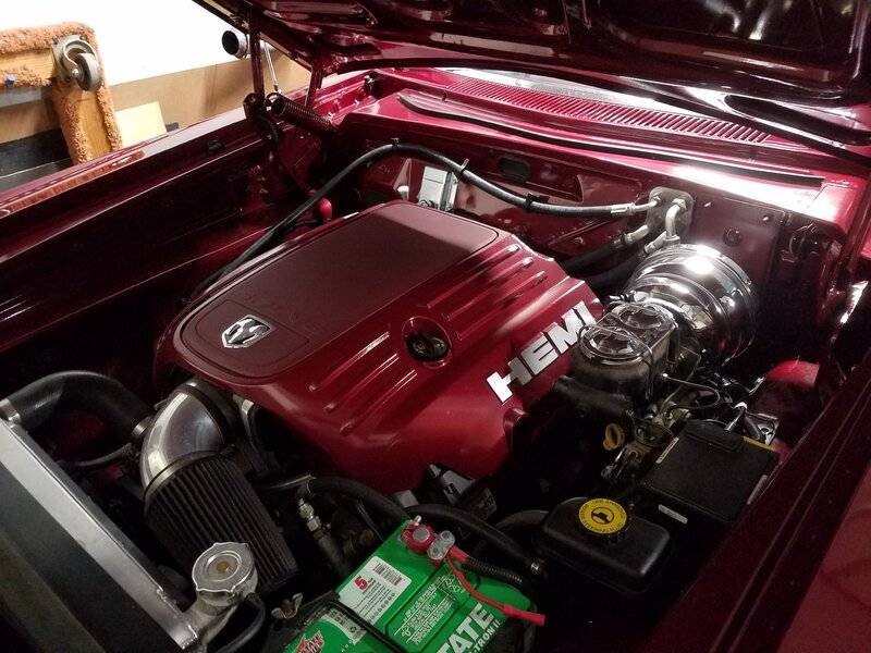

Mine is similar to that.

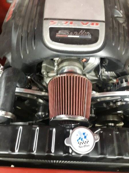

My donor car came with the K+N cold air intake already installed, so I decided to keep it.
I modified it slightly by cutting about a 2" section out of the pipe where it attaches to the filter. This gave me sufficient clearance to the inner fender (so it would not touch/rub).

Where did you put your air temp sensor?
There is just enough room between the air cleaner and the throttle body in that stainless connector between the two. It is hidden on the right side bottom.
