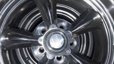

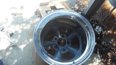

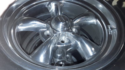

New today. 15x12 5 on 5"

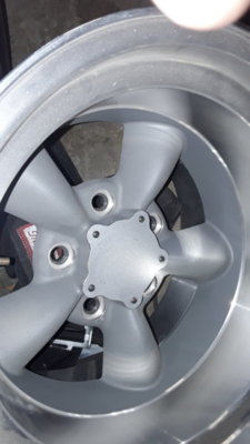

16x8 1/2, 5 on 4 1/2. Can you see the cutout on the center hub? Its there for socket clearance for a normal size stud.
The other wheel is also 5 x 5 . No cutout needed.
