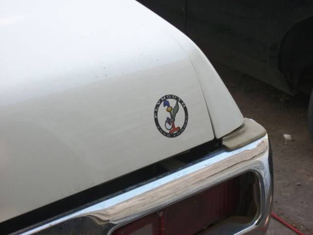

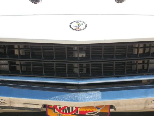

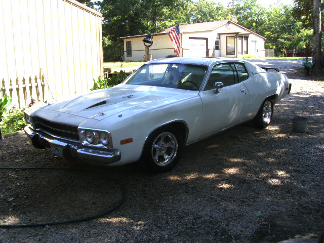

5 days, lots of hours, and voila! a White Roadrunner!

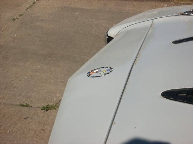

Congrats bud, great job! i'm doing the roof on my 74 RR now. One question though, I noticed the rust below the roof seam and it looked like the P.O. used bondo on the joint, hence the rust. How did you re-fill the roof to quarter joint?

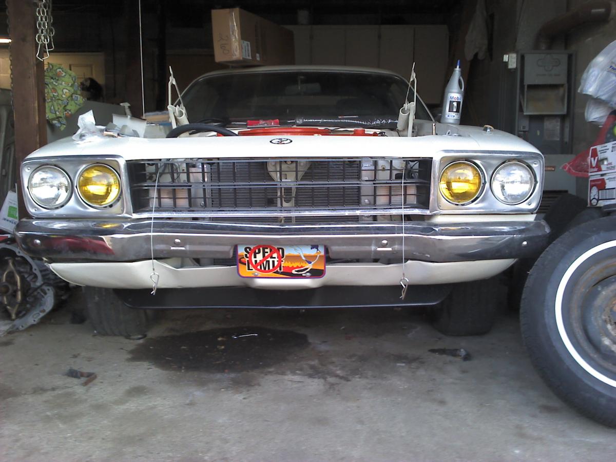

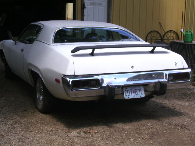

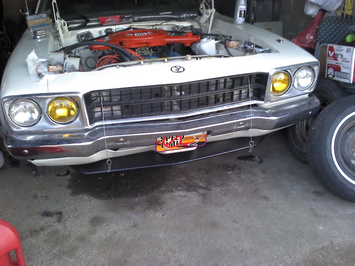

update... got the spoiler wing on, got the new oil pan on, got the k member cleaned up, got the new headlight bezels on.
kinda messed up on the spoiler wing though.. tightened the four bolts down a little too tight and bowed in my decklid at the pedestal mounts a little bit. sux for me, but to hell with trying to fix it. its just going to have to stay that way.
why they bowed you may ask? my decklid was not made for a wing.. no cutouts on the bottom. I "should" have used my step bit and made cutouts and then mount the nuts/washers to the pedestal mounts right below on the top metal of the decklid.. BUT... I didnt... so I will chalk that up as a learning experience. looks pretty dang good though.

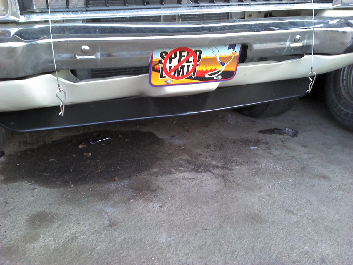

front spoilers look to be a pain though. I actually have to flatten out part of the plastic spoiler so that it will fit the curvature of my fender. My passenger side valance is pretty "not" straight, so I will have to fix that before I even think about mounting anything up front. I will save that for a later date. it is late and I am tired, so I will put up pics later.

Great job once again! Two pieces of advice for you. First, from your first photos, put some foam "pipe wrap" around your floor jack handle before you have to learn "dent-pulling" too! Second, you may be able to shrink the metal around the pedestals by using the dry-ice method. Look it up on you tube!
good points... i was going to take the wing off, use my step bit to enlarge the bottom decklid holes and then see if i can use a lil body english to push (ever so gently) the pedestal mount areas back up to where they need to belong (or close to it). but until then.. it will be the way it is lol. thanks.

yeah, just need to buff out the paint first. I got the kit, just need to put it on. I actually want to get it running before I do any more cosmetics. There is something about having a car "go" with the "show" aspect.

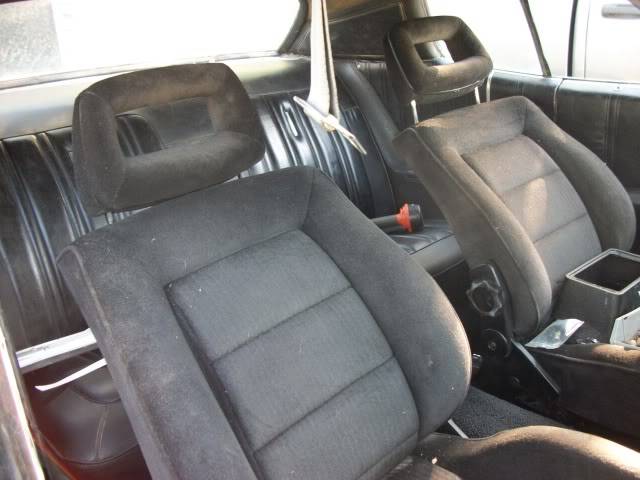

well its been a while so here is an update

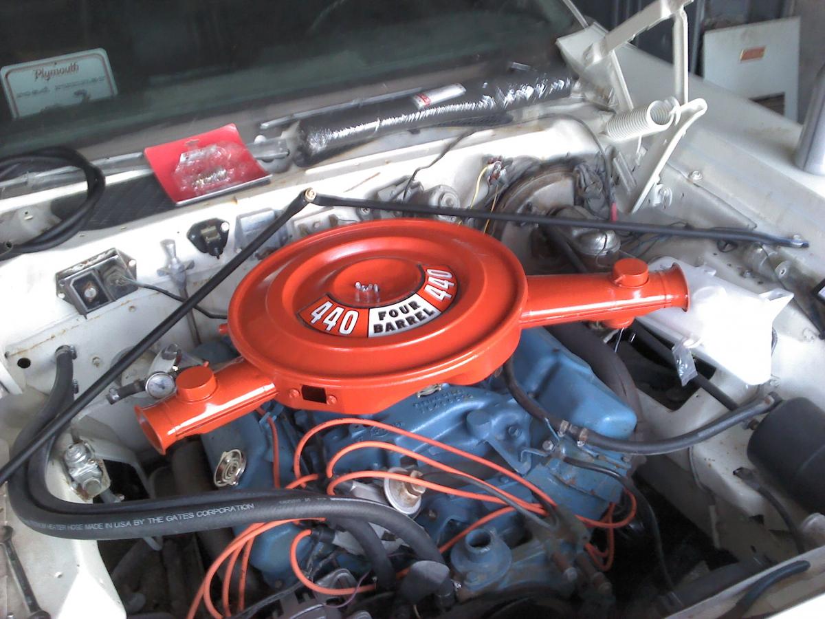

no pictures, but i went ahead and dropped the gas tank.. its toast.. rust inside.. got a new one coming in this week. had to relocate the electric fuel pump so that it will "push" better than what it 'was' doing. reworked my fuel lines to clean them up in the rear right quarter/framerail area. radiator has a leak.. pulled it.. picking up a brand new one tonight from oreilly's. i will try and get it running tomorrow from a gas can just to break in the camshaft. 98% done.. and i am going crazy waiting for the next 2%
