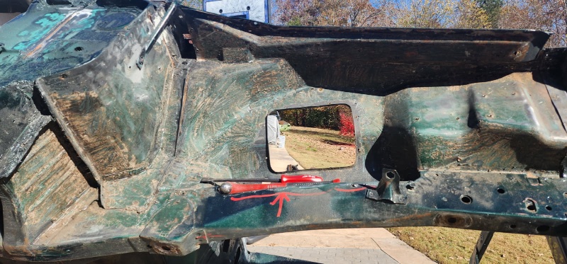

1 wheel cleaned of undercoating

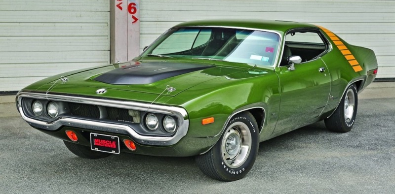

That’s funny. I showed him that exact same ad today and suggested red. He wasn’t enthusiastic about the red, but then did mention maybe dark orange.As an aside, here is a factory ad for the '73 RR; green sporting red stripes:

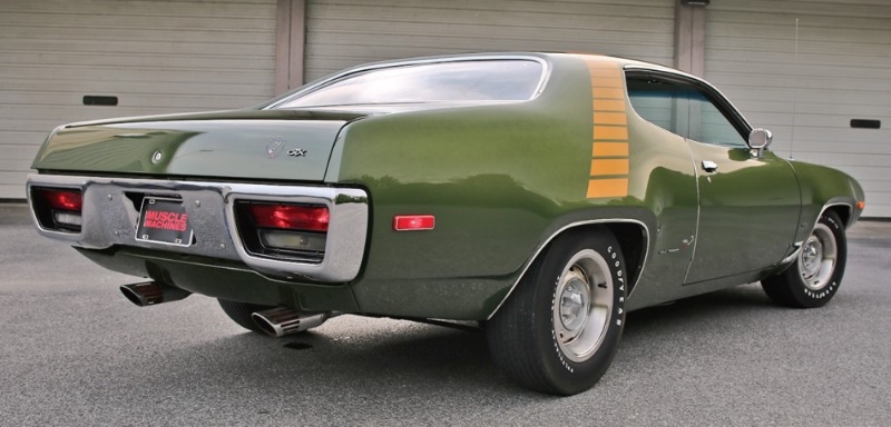

I like that. I’m gonna show him this.Just want to share one of my FAVORITE green B-bodies:
Has anyone ever seen a green w/red stripe car?? That's a bold choice for sure and I bet it looks pretty cool. My 73 is B5 w/red and the only other 71-74 B- body I've seen that scheme was a Charger, can't remember for sure but I believe a 72.Then go with orange stripes. Just want to share one of my FAVORITE green B-bodies:
Only in that ad. Never seen another one. When I showed to my painter he said Christmas Tree.Has anyone ever seen a green w/red stripe car?
