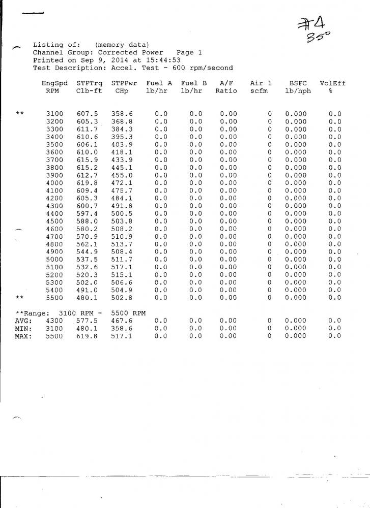

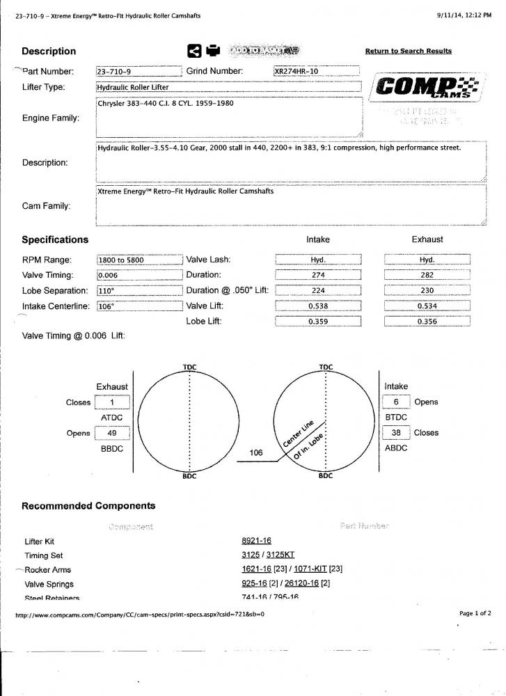

Gentlemen, I would greatly appreciate it if you would review the build sheet and dyno results on my 500 Ci stroker and give me some advice on how I can change the HP verses TQ ratio on my dyno results. I currently have it up for sale on the performance parts forum, but it would be much easier to correct what I assume are head and cam issues on my engine, than to buy a 572 hemi just to prove mine is bigger!. As a street engine it definitely fits the bill, but the horsepower numbers concern me when you take into account that it makes 619 ft. lbs of torque @ 4000 rpm, but only tops out @ 517 HP at 5100 RPMs. Please take a look at the numbers and offer any advice on how I can achieve a better HP to TQ ratio. I'm assuming some may look at the numbers and not see a real issue since it will be a street only car, but I have a lot of change invested in my 68 GTX and I need an engine that will help me sell this car without taking a huge loss.

That's a helluva stump puller! Was your engine builder present during the dyno runs? No mention of carb/intake/head combination that you're using with that cam...

Yep, it does have a toy camshaft and entry level cylinder heads. I cannot decipher the intake manifold type though.
Yes, Harold from R&R ran the dyno runs. I am running a Holley 750 HP double pumper, Edelbrock RPM dual plane intake, and Edelbrock E-Street heads out of the box.
I appreciate the input! Harold installed Edelbrock E-Street heads out of the box. I was thinking of trying Trick Flow 270 heads which won't be out until July or August and new cam that will raise the HP and hold raise the RPM a bit before I hit max TQ, but still keep it a well behaved street engine. The top speed isn't a priority since it won't see any track time, but I'd like to leave a nice impression on her next owner. I thought I'd hand it down to my son, but my old lady says that it's either it or her. I can get a new old lady, but I can't get back half my Marine Corps retirement, nor half of everything we have.

You already know what to do to change the engine. When you bolt on a small cam, small carburetor, and heads that have a maximum horsepower capability of 520-540HP OOTB. You are only going to get what you already got.

Check what the bowl looks like on the heads, maybe a cleanup there would help. The 500" motors seem to want fairly large cams. At least mine responded to a bigger antique cam I had. The 500" street motor in the car I bought had a Comp XS274S cam and dyno numbers about the same as yours. I put in the antique 585 Cam Dynamics cam and a Victor intake and picked up 7 tenths and 10 mph. Small cams make great torque & fair HP but they want more air, bigger cams. My $.02.
IQ52 hit the nail on the head.. Both the heads and cam are your limiting factors. But I would drive and see how it runs and just talk TQ numbers.. The motor he built for 69GTX has me drooling and sent his specs to my Engine builder..
You're already producing more tq/hp than you can put to the pavement anyway, so why not drive it as is? More power would be nice for comparing dyno sheets, but not a whole lot more.

You need more than an intake manifold change...........but here is a direct comparison between a ported RPM intake and a Victor that has the plenum, right under the carburetor, lightly blended. Mind you, not ported, but any sharp points rounded off. Both intakes were gasket matched to standard port size.
........496 stroker, 10.3:1 compression, 91 octane, Edelbrock RPM heads ported to flow 292 cfm @ .500" and 309 cfm @ .600" lift, Lunati solid street roller 249/255 @ .050, .585"/.600" w/1.5:1 rocker arms, 950cfm Quick Fuel Q950 carburetor.
RPM..............TQ/HP RPM intake............TQ/HP Victor intake..............yours
3000.............541/309........................530/303..............................N/A
3200.............570/347........................554/337...........................605/369
3400.............614/398........................591/383...........................611/395
3600.............639/438........................612/419...........................610/418
3800.............638/462........................613/443...........................615/445
4000.............639/486........................615/468..........................620/472
4200.............628/502........................613/490...........................605/484
4400.............611/512........................615/516...........................597/501
4600.............607/531........................616/540...........................580/508
4800.............607/554........................614/561...........................562/514
5000.............609/579........................623/593..........................538/512
5200.............614/608........................620/614...........................520/515
5400.............597/614........................614/631...........................491/505
5500.............596/624........................611/640...........................480/503
5600.............590/629........................602/642
5800.............578/638........................584/645
5900.............570/640........................582/654
6000.............550/628........................565/645
6200.............535/631........................549/649
What do you think, is the torque of little use?
