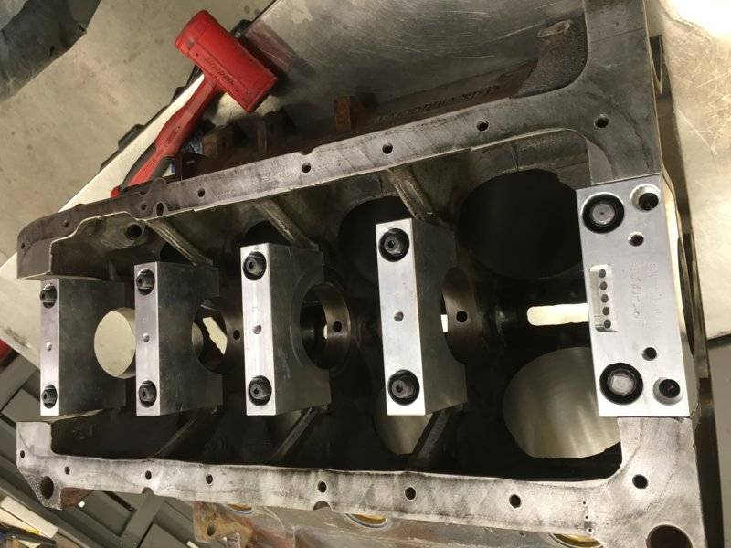

I have spent about $8500 so far collecting parts and machine shop costs. Where it stands so far is;
Short block built at the machine shop, machine work done, rotating assembly installed, cam bearings and plugs installed, short block ready for engine assembly, . Machine shop bill was $1100. I sent them the 440 Source kit which cost me $2300.
