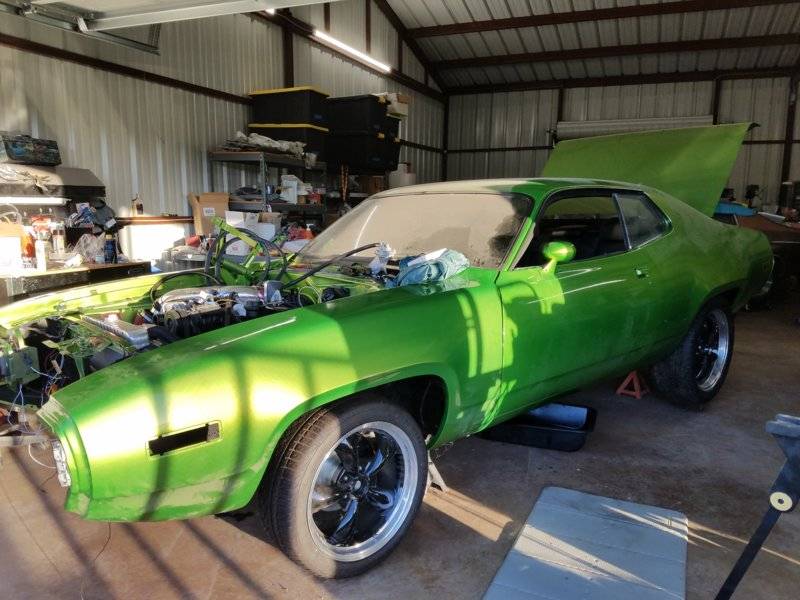

Bottom line is it won't turn the tires.
I have a 71 Satellite that I've put an 04 5.7 hemi and a 545RFE. I have a harness from hotwire and they flashed the computer. The linkage works and selects the gears. I know it is seeing something because it will not start out of park. I found a thread about the problems this trans has if the filters are dirty. I changed the filters. I filled it with Mopar trans fluid. Still will not turn the tires. Any suggestions are welcome.
Thanks
Joe
