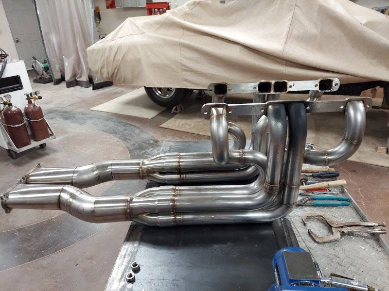

we built our own headers and do not have room for that or I would do all now as well. If I could add pics easily on here I would show them
they are to close to engine compartment sides.

we built our own headers and do not have room for that or I would do all now as well. If I could add pics easily on here I would show themView attachment 1430109
Mine were close as well. I cut the studs short. My headers are multi-piece. You have to install the front tube and the center tube section as a unit. so it was hard to hold them up and start the bolts. Took 2 people. i just did a 68 B body it had studs. Dougs 452 headers. No go. Had to remove most of them. But was able to keep the front and rear studs.
