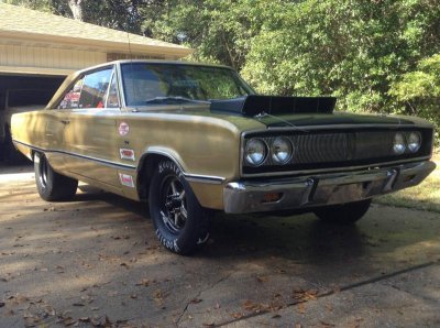

Looking to see what you guys are running as well! Currently have a 67 Coronet I am trying to lighten the best I can, weighed @ 3700 w/ full interior and 3/4 tank of gas with me in it.
Goal is to eventually be a consistent 10.50's car. Maybe I'm just dreaming, but that's what I'm striving for.
