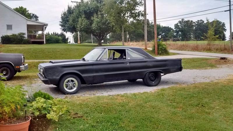

Looking to see what you guys are running as well! Currently have a 67 Coronet I am trying to lighten the best I can, weighed @ 3700 w/ full interior and 3/4 tank of gas with me in it.

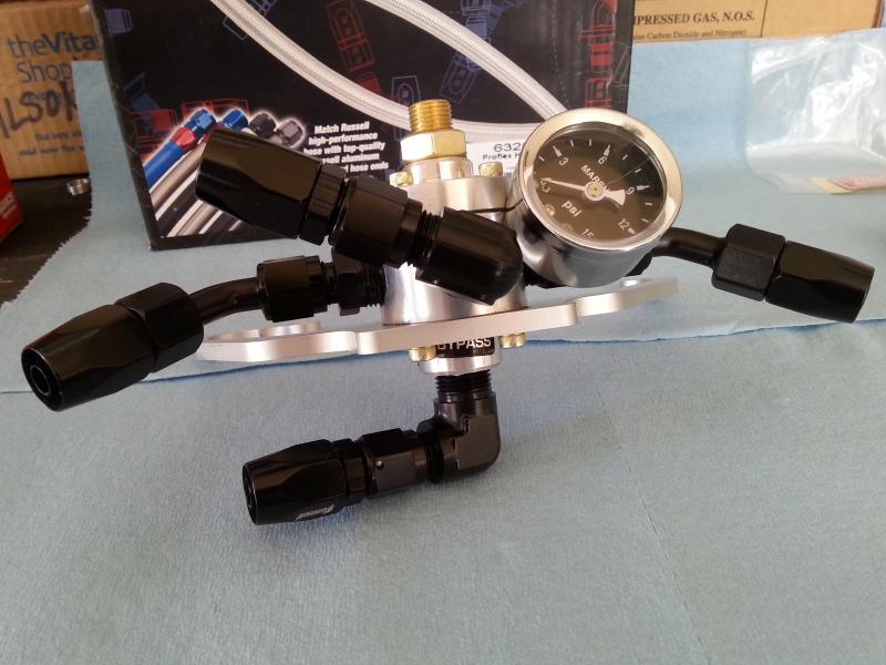

View attachment 298898Best Wheels Up.jpgView attachment 298892CalTracs.jpgMotor with new lines.jpgreg 2.jpgScan0005.jpgYou are going to need at least minimum 650HP, You gotta have 350 flow heads with Max Wedge Size ports, Max Wedge Single Plane Intake, 1050 Dominator, Massive roller cam and pistons to accomodate that cam lift, Steel Billet Girdle and Steel Billet Main Caps, Roller Rockers, MSD Dist, Return Style Regulator, $300 fuel pump with correct plumbing, 2" headers, etc, etc, etc. 5000+ Converter, Complete Cal Trac Setup and good slicks to go 10.50. You gotta go 1.40 or so 60 foot to get to 10.50. And if you have 650HP you are going to need a DANA 60 or you will break the 8 3/4 (fact).

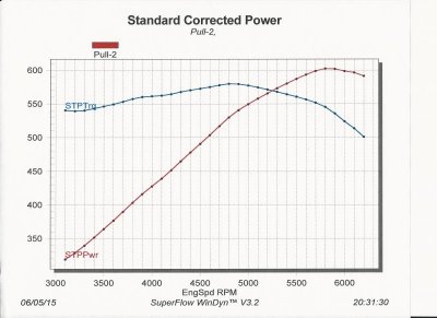

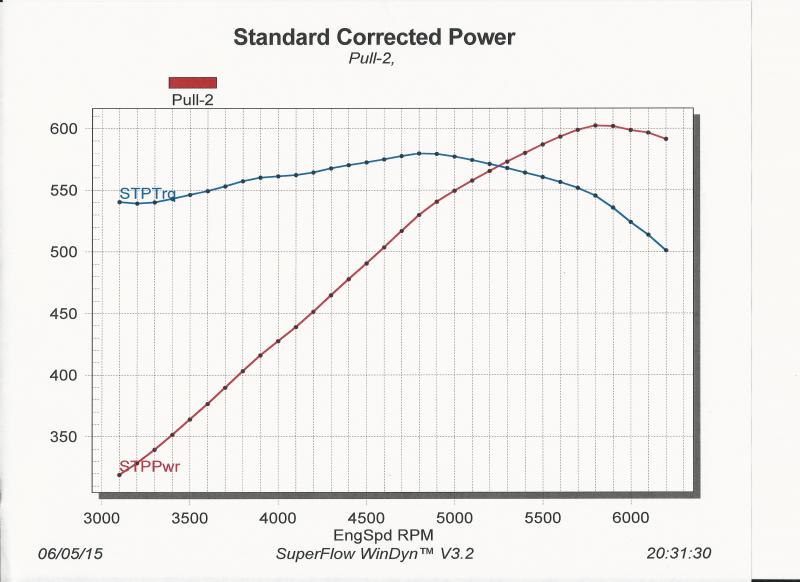

My new motor makes 602HP (on the engine Dyno) and it is a 505", .620 Comp Solid Lifter Cam with 1.6 roller rockers, 12.2-1 pistons, girdle and steel billet main caps. 1 7/8 Hooker Super Comp Headers, Indy SEZ (non-max wedge ports) heads with INDY Dual Plane Intake and 850 Mighty Demon. (just sold the Intake and 850 and am replacing that with my new Victor Single Plane Intake and new 1050 Dominator all in the effort to get to 10.70 (and if I am really lucky to get to 10.60) I have the complete cal trac setup, DANA 60, 5000 Converter by Lenny at Ultimate Converter, etc, etc, etc until I am just tired of spending money....lol.

View attachment 298898View attachment 298891View attachment 298892View attachment 298894View attachment 298895View attachment 298896View attachment 298897You are going to need at least minimum 650HP, You gotta have 350 flow heads with Max Wedge Size ports, Max Wedge Single Plane Intake, 1050 Dominator, Massive roller cam and pistons to accomodate that cam lift, Steel Billet Girdle and Steel Billet Main Caps, Roller Rockers, MSD Dist, Return Style Regulator, $300 fuel pump with correct plumbing, 2" headers, etc, etc, etc. 5000+ Converter, Complete Cal Trac Setup and good slicks to go 10.50. You gotta go 1.40 or so 60 foot to get to 10.50. And if you have 650HP you are going to need a DANA 60 or you will break the 8 3/4 (fact).

I dont have a return regulator
