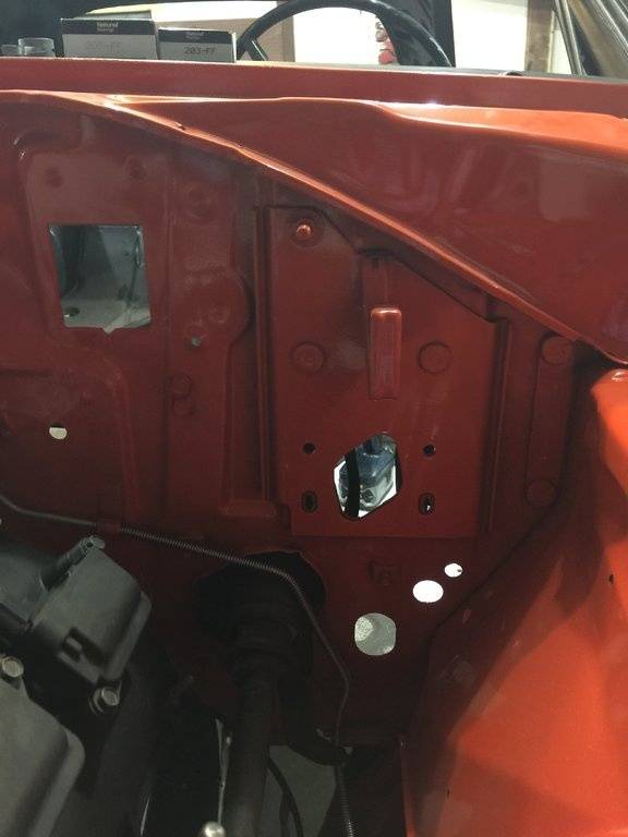

Morning men getting ready to install wilwood into 70 b body with 6.1 hemi.We plan to use the factory pedals in the car. I bought the latest and greatest from american powertrain that fits for the b body. Does any one have any pics of where they placed the slave on the firewall? Running out of real estate?
Should be that big oval hole just to the right of the steering column.
Well we made it happen! Installed the master brake first and the clutch fell right into place. Will post some pics. We are using the factory pedals and made that work too just don't have a nice long stroke on the pedal but it is what it is.
Hey 5,7 do you have any pics of how you set up your clutch pedal? Did you use your factory pedals off your old car or did you install the pedals from the newer 5.7 stuff? Any help appreciated thinking about using pedals off 2010 srt challenger?
Mine was an automatic. The bottom oval hole is where the clutch rods goes. You can use the factory pedal that came with your car, or, use a hydraulic clutch mc, they work awesome!
Yes sir we are in the process and going really good just thought you had a 6 speed thanks for all the help.
