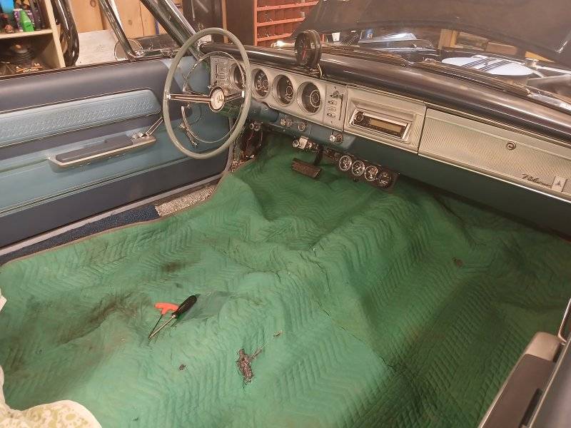

Started the conversion last week. Taking out the front seat and because the car is a convertible, dropping the top makes interior access a ton easier.

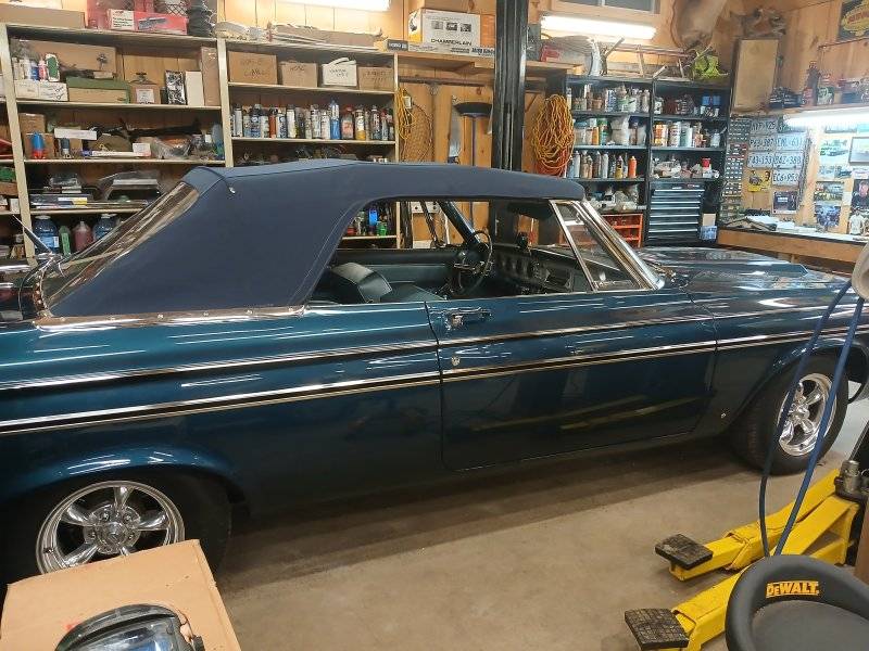

Photo of car before I started.

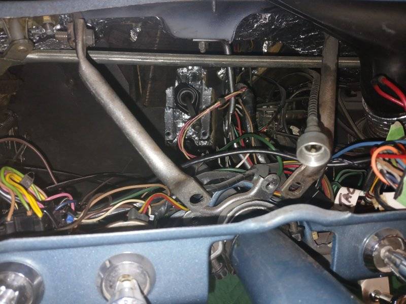

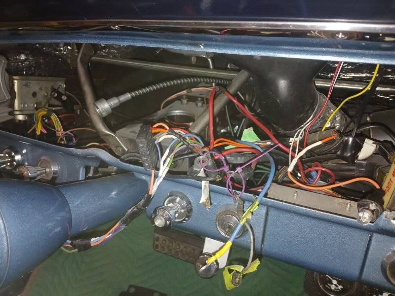

Next the dash comes out for easier access to change the pedals

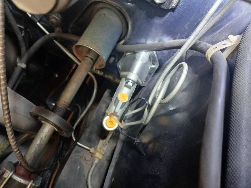

Pedal assembly removed

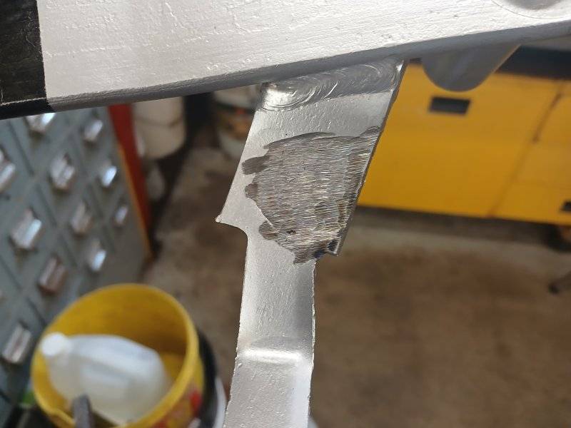

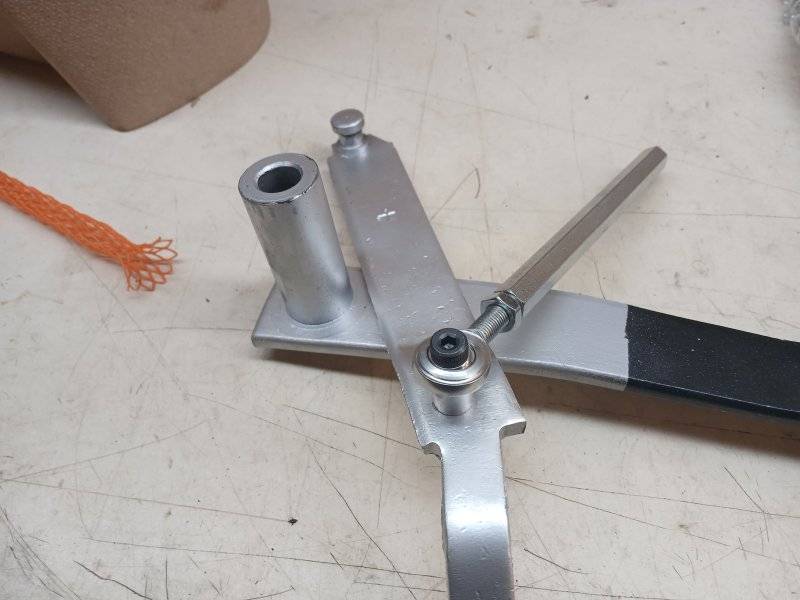

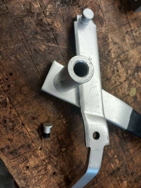

As per kit instructions, I removed factory clutch rod pin on the clutch pedal and installed supplied adjustable rod with new pin. I ground off the weld and the factory pin was knocked out.
After mocking up the new pedal assembly and hydraulic slave cylinder in the car, issue number two is apparent. Things don't line up and the connecting rod is to short.

Started the conversion last week. Taking out the front seat and because the car is a convertible, dropping the top makes interior access a ton easier.View attachment 1788464
Pedal assembly removedView attachment 1788475

As per kit instructions, I removed factory clutch rod pin on the clutch pedal and installed supplied adjustable rod with new pin. I ground off the weld and the factory pin was knocked out.View attachment 1788488View attachment 1788489View attachment 1788490

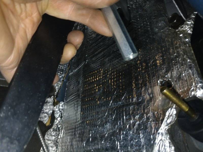

View attachment 1788494View attachment 1788495
I sent a note to SST today with a few pics and will be on the phone with them tomorrow to try and resolve this issue. More to come!
