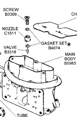

Hmmm, valve hanging up or missing? Seat fouled? Wrong or compromised gasket not sealing the pump circuit?
how does the engine start-up after the "leak down"? a leak down of that magnitude would be a difficult engine start-up.
USUALLY, a new check valve weight (# B-3318) is included in the rebuild kit, with nstructions saying: "using a small diameter drift pin, lightly tap the old weight with the drift pin a light hammer blow, forming a new seat, invert the body, allowing the old weight to fall out, then install the new weight, along with the proper gaskets, nozzle and discharge screw". This procedure fixes any pullover fuel delivery issues caused by a leaking check valve issue.
Another potential problem area is the use of NON HOLLEY inlet needle and seat arrangements. Some non Holley parts use a backward arrangement from the Holley design .... using the external slotted screw to adjust the float level, rather than the hex nut. Leaks can develop both internal and external to the float valve assembly. .....another point to consider...
