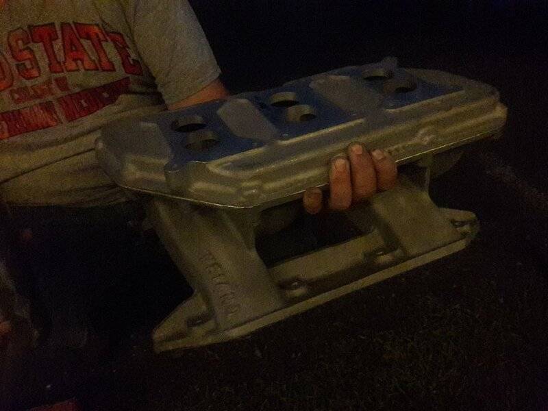

I would really like to make this intake work because of the wow factor. I've heard there are issues with it and want to run it on the street . Has anyone had success? I'm running about 10.5 to 1 compression and 240 trick flow heads
Its Weiand p3690982

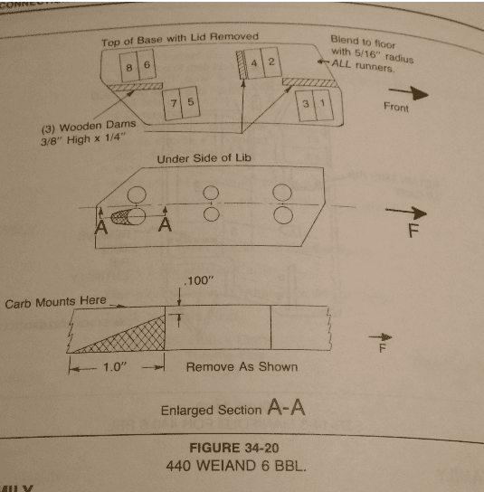

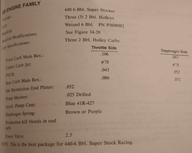

It's a early 80's 440 Super Stock piece. Very impressive, but generally need lots of modification to make them run good back in the day. The Mopar Bible P4452790 page 333 & 334 Figure 6-83 has their recommendations for a Super Stock motor. I'd do the manifold mods in Fig 6-83 & play with the jetting.
I knew a few guys that used the Weiand manifold, no mods weren't any faster than the stock Edelbrock 6 pack manifold 7 carbs. A couple that used the Mopar combination did OK. But there are a few guys that have different combo's. Maybe check with Biomedtechguy, he's done a lot of investigation.

The fixes were airdams in the plenum, to fix distribution problems. Basically, "popsicle sticks" glued into place.

I did the mods on the Weiand and it ran great. I also rounded the entrance to the runners with a slight radius. The angle cut at section AA is important, port 7 was running super lean before the fix. I will try and take some pictures this weekend.
I had modified my carbs per the Mopar recommendations but decided to try billet metering blocks (all 3) even using the same (as previously resized main jet sizes) yet when I had the car dynoed it was very lean at wide open throttle. We rejeted the secondary carbs (only) and gained 30 horse power. Went 10 sizes larger!
Mike
When doing the mods on the jet plates be careful. With my 1st 6 pack I tried the Mopar mods on the end carb jet plates. Got the selection of number size drill bits, use a "pin vise" (small hand held held bit holder) to do the drilling. The car developed a big miss that I chased for quite a while. Pulled the jet plates & examined them with a magnifying glass and could see tiny swirl marks, bought new stock end plates and no miss. Later talked to a local carb expert that told me the proper way to do that mod was to use reamers not drill bits.
Thanks for all the input!! when I saw it I had to have it !!! Always thought a six pack high rise would be cool and thought it would just be a simple bolt on . So with all the mods and headaches people seem to have , cabs being so expensive plus it's never been on an engine I'm not doing anything with it!

BTW, of the guys I knew back in the day, no one had anything bad to say about that manifold. It just took the effort to make it work to the best at drag racing. My engineering background tells me that the mod in Figure 34-20 is VERY important, radius the entrance to runners on the base too, the dams less so. MHO

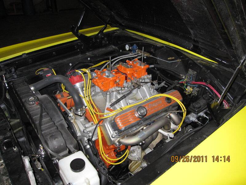

I drove this intake on the street in my road runner for a while. I had issues with my fuel system that I was unaware of at the time, so my tuning info is somewhat bogus. Would have loved to run it after fixing the other issues, but I traded it off before having the chance. I can tell you that it fits under the liftoff hood (barely) if you use the stock height air cleaner. it looks menacing through the scoop opening. I was able to run 11.42 with it, which is right where it ran with a TM7 and 750 Holley. Good luck.
