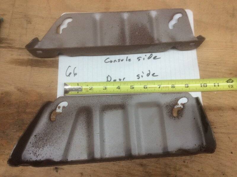

66 bucket seat brackets floor to seat. note the tilt adjustment holes.

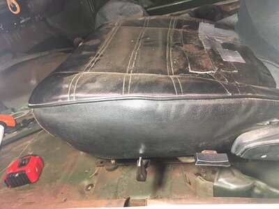

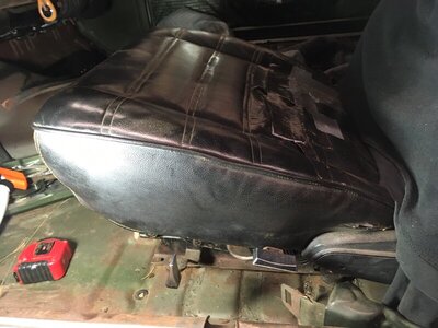

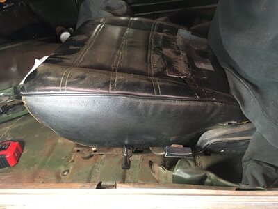

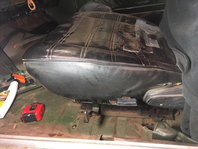

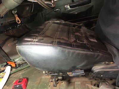

Hard to see all the different positions of seat because I moved slightly with each photo, some times you have to look at the seat track to see the height change, first is level, then all the way "reclined"
the 3rd is one click forward from reclined
Wow Fran Blacker, I never knew about the 66 tilt adjustment, and I drove a 1966 Charger for 15 years!!!
Did they all have that or was it an option?
Wow! Fran Blacker and B-rad, thank you! this is so helpful. This gives me plenty to chew on and study. I like the idea of just adjusting the tilt vs. getting the new tracks but now seeing the pics, I don't know. Man, thank you both!
Don't know think they all did with buckets. Have 2 Satellites, both had them. Ones a parts car and these are from it. If you can use them $30 plus shipping. Only have the two.
Thanks, but I have two spare 67's from my parts Charger, when I get a chance, I am gonna look to see if mine have those holes.
All 1966 buckets came with those adjusters. It’s in the owners manual They were gone in 1967.
