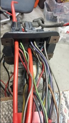

I'm using a 100 Amp modern alternator in my 67 Charger, all going thru the original ammeter.
The ammeter is very good to have, I know if current is going in or out. The wiring is beefed up alternator-ammeter-battery, and straight thru the bulkhead connector.
Important with stiff wires is to not have them bending on the screw terminals in the ammeter, and of course no loose connections.
The amount of current is no problem, the original ammeter can handle more current than the alternator will output.
Attaching a picture showing my bulkhead connector. I've since used Howies hockey tape to make the wires look original, and also tested that the hockey tape doesn't burn.
It all works nicely.
