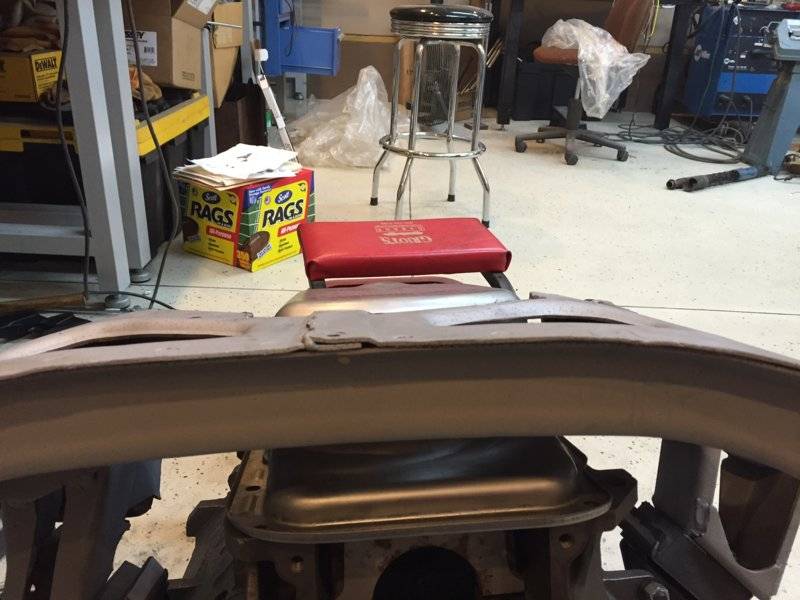

I am struggling to find a replacement oil pan for my 63 Belvedere 426 Max Wedge. I have been all over the web, Milodon, Jegs, Summit etc... with no luck. I bought and tried the 5-1/2" Milodon (pn 31580) but the K-member on the 63 would not allow it to fit. I see 65 and older pans all over the place but I guess the K-member was redesigned then.
Does anyone know of a place that remans the 2402307 (6qt) pan or ANY pan that will fit the 426 in the stock 63 chassis?
I have no issue with an after market (non-OEM) part as the car is not a perfect restore. The pan on it was a Milodon, 7-1/2" deep. Problem is, not enough clearance. Road rash got the better of it.
Any ideas or info would be greatly appreciated...

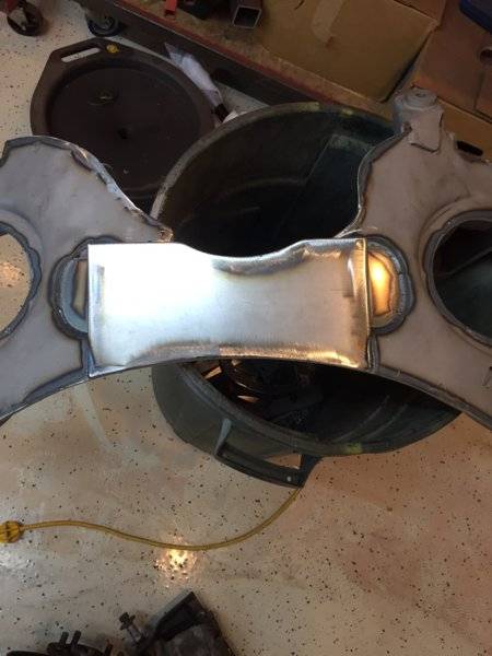

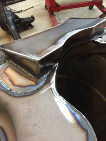

I had the same trouble for my build. Chooch may be referring to my post, under the 1962-1965 Mopars section. Look up BB/Hemi Oil Pan Project. The pan turned out pretty good, and may do another for my '65 when I get to it.

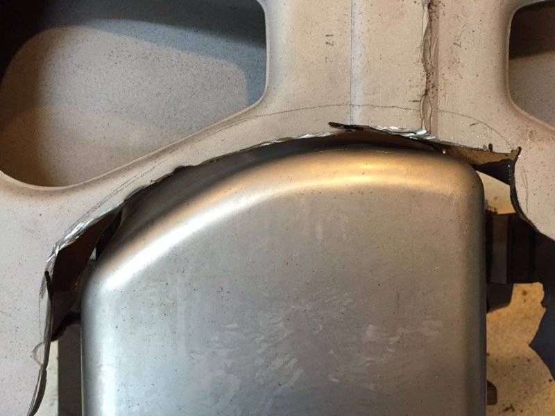

I put a Milodon pan in my 64 Polara 426 wedge. All you need to do is make a small notch in the passenger side of the K member and in you go.

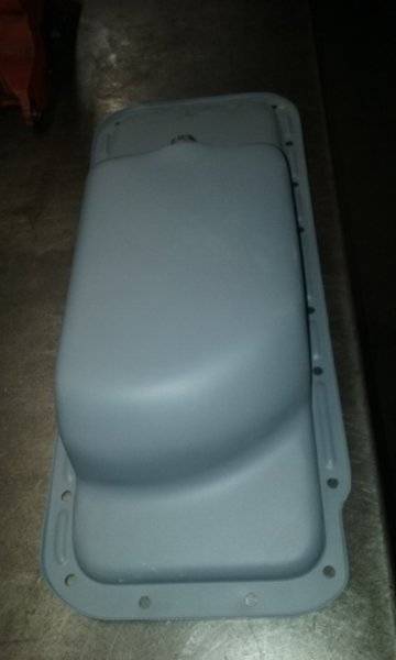

Thanks all for the help. Found a stock one. Cleaned and painted. Cruisin' with confidence!

Just cut a very small notch in the passenger side of K-member and your milodon will fit.

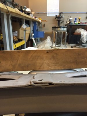

I used a Hemi oil pan on both my 62 Dart and my 64 Plymouth just had to trim the K frame a little even made a skid plate
FullSizeRender (1).jpg IMG_0972.JPG IMG_0973 (2).JPG IMG_1004.JPG IMG_1005.JPG
