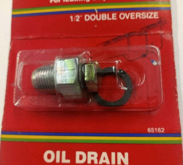

If the mating surfaces are really flat than the problem has to be the plug to pan thread fit. If this s a pan that has seen a lot of oil changes than the pan threads may be worn. Solution is to either the pan or use an oversize threaded drain plug.
Available in different sizes.
