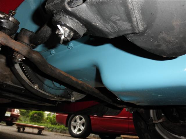

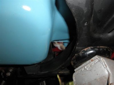

I'm not sure about the 440source oil pan. I used a Mopar oil pan P5007807AB and pickup P5007848 on a 65 Satellite with a 440. It's a 3/8 pickup. I don't know if a 1/2" pickup is available. As you can see in the pictures, it fit pretty good.

I found that the 440Source pans rear was to deep. It rubbed on the steering linkage. The Milodon fit nice. I also had to make a small notch on the K member no big deal.
Every dot source pan I've seen won't bolt up correctly. I bought a oil pan on Ebay and it fit perfect. Both pan and 3/8 pickup for $99.
I bought the oil pan from 440 Source and haven't had any clearance issues... I would recommend it.
