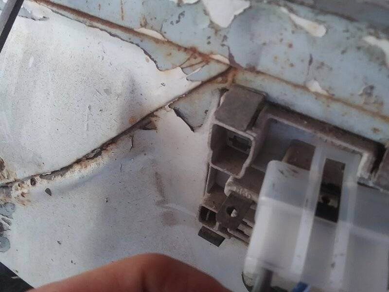

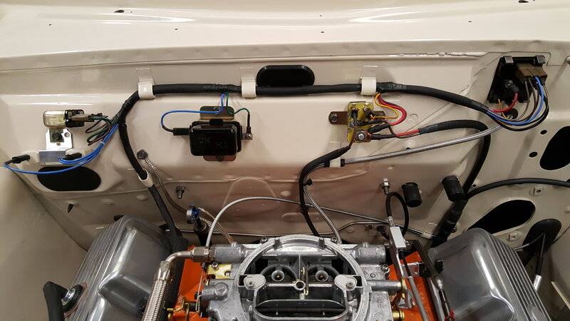

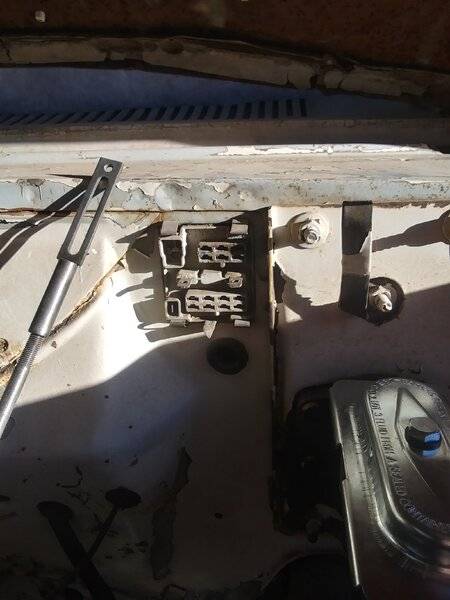

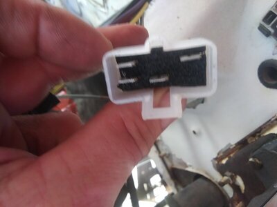

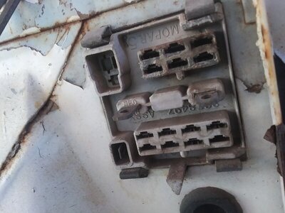

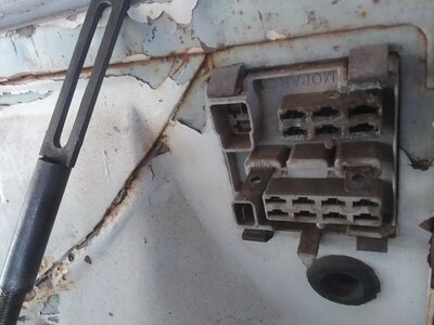

Ordered a 62-63 big block bulkhead engine wiring harness, trying to install it and it looks all good except for the plastic connector that slides into the bulkhead. the plastic tab won't allow it to fully insert it in, unless I cut that tab off.anyone have a picture of a correct bulkhead with the engine compartment wiring installed ??

where did you get the wiring harness doesn't look like mine ??? There is no clip on the side on the one I've got...

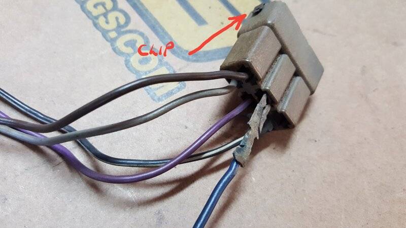

The clip on the side of the connector (there is one on each side) holds the connector tight to the bulkhead.
