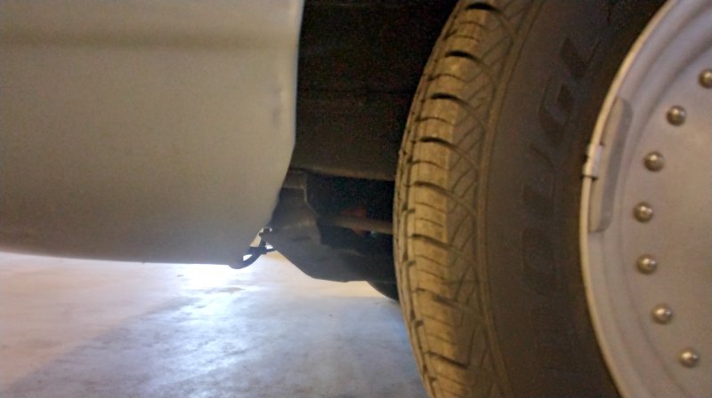

62 Fury with 225/70/15 tires (pictures of front fender/ lower valance clearance)

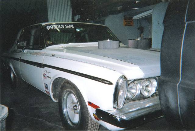

Common problem. Here's pictures of my '62 Dodge and a reply that looks like the Plymouth. Same size tires. I didn't modify my fenders and never had a problem rubbing yet. When the car is jacked up it looks closer than when the car is on the ground.

62 savoy. Currently has 215/65x15s on it, so don't go by that. A previous owner relieved about an inch and a half from the valence, more material removed toward the inside. I can run a 235/75x15, 29" tall, without rubbing the fender..... it only rubs on the header tube approaching full lock. The 235s are on the tt2s in the last pic. 15x7, 4 or 4.25 bs, don't remember exactly.
Thanks guys. I was planning on 235/70/15 or 235/60/17 with a diameter of 28"...but on all four corners. But I'm starting to think that 225/70/15 or 225/60/17 about 27.5" diameter might be a better choice. Not sure if I want to trim the valance panel end caps, just for larger tires. My current size is 225/60/15 25.6" diameter just looks to small in the wheel well opening.
My 65 had 225/70/15 on it. Helps ?
No rubbing.
it should also depend on rim offset too , ,15x6 1 plus pos n 205/75x15 no issues

Can anyone snap some pictures of 62 Fury front fender/ lower valance clearance with 225/70/15 tires ?
These are 215-70-15 with Cooper GTs. I believe they are around 26.5” OD. I have a set of 8.25-14 bias ply that are around 27.3” OD and personally I would not go bigger than those on my car.
