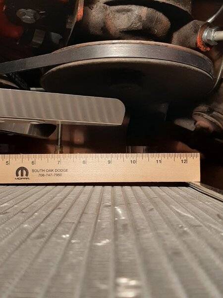

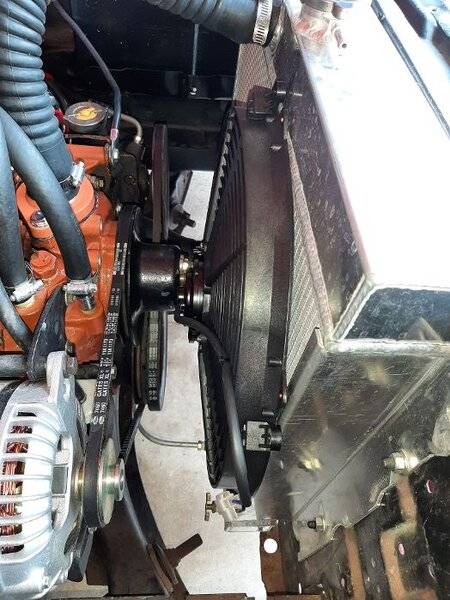

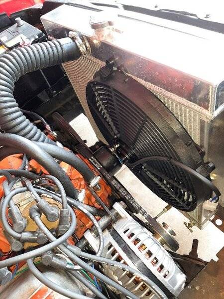

I have a Champion radiator on my 62. I bought a Champion aluminum fan shroud to fit the radiator and then eventually drill holes for a 16" electric fan to assemble to it. I removed the fan blade from the water pump bolts and put the bolts back into the water pump/alternator pulley. Before I did anything else, it "visually" looked real tight in the clearance space, so I just placed the fan onto the radiator WITHOUT the shroud and sure as SH**, there is NO ROOM whatsoever! Am I missing something here? I searched for Mopar car pics with electric fan setups and can't find any. Any help/suggestions would be so great! Is my ONLY option to put the fan on the FRONT of the radiator with NO shroud?

First thing I see wrong is the fan itself. That fan is to small and is not pulling air through all the radiator fin tubes. The radiator also looks to be very thick. A low profile fan with shroud that covers all the fin tubes may work. I also would ditch that flex fan.

try 2 smaller fans, maybe that will work , it did on my griffan radiator

Yep, I have seen two and four fan configurations, but the shroud was certainly custom made.
My 62 440 uses a Cordoba big block high efficiency 26" copper radiator (probably thinner than yours) a modified Cordoba shroud, and a 17" (might be18) flex fan (no clutch, the clutch eats room!). I run a 14" pusher in front for between rounds cooling. It isn't necessary driving around.
