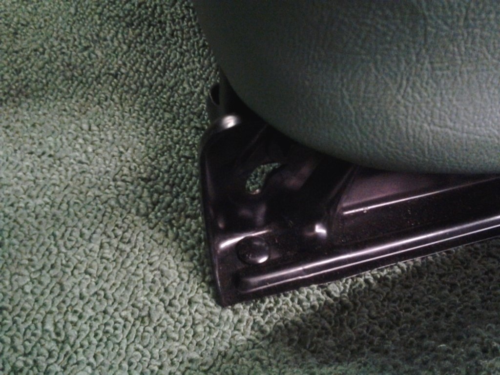

I had the same issue on my 62 Dart (bench seat). If yours is a bench seat swap the brackets that bolt from the floor to the seat frame left to right. I had mine reversed.

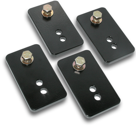

Yearone has Universal seat relocation brackets.
https://www.yearone.com/Product/chrysler-b-body/sb246#prettyPhoto

Here are a couple of pictures of the driver side floor mount bracket
