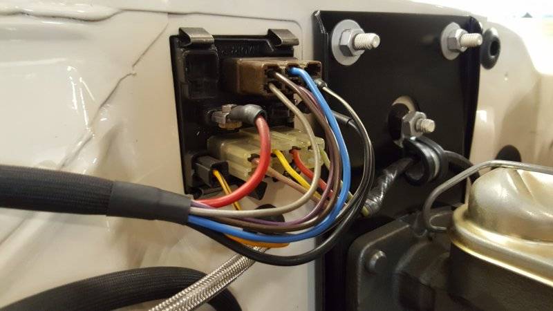

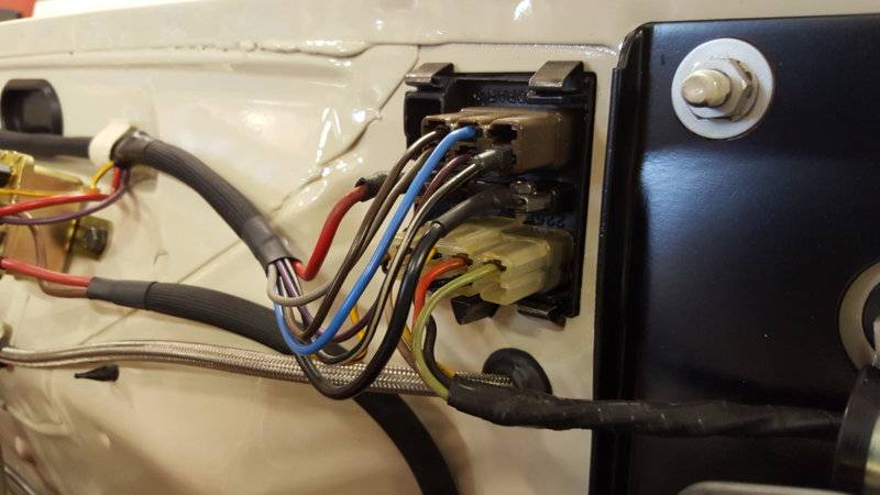

Here's the one on my '62. They should be the same.
Look at the last reply on this thread. Member says he has 1963 connectors. (Old add)
https://www.forbbodiesonly.com/moparforum/threads/1964-fury-bulkhead-connector.63742/

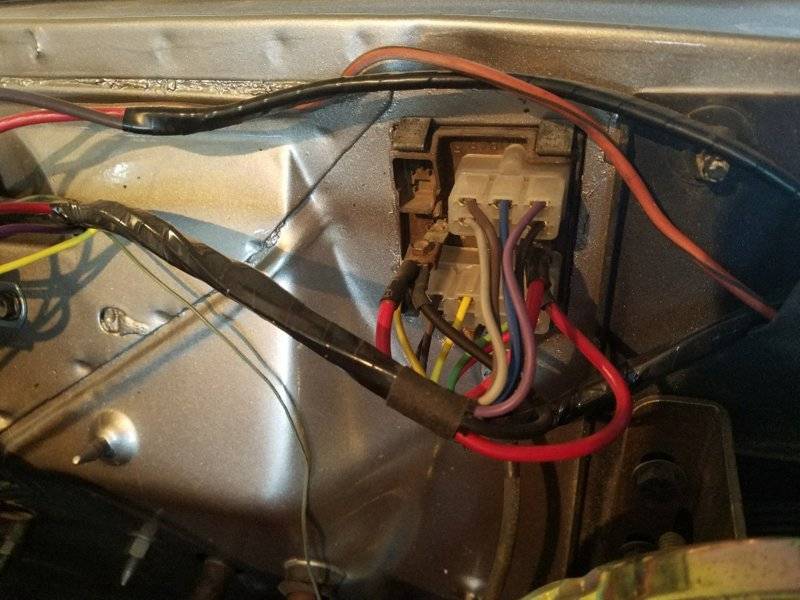

I'm not exactly sure what you are needing to see with pictures. Wireing? Just the empty connector? Looks like the '62 and '63 has two metal lugs molded into the block and '64 doesn't.
I'm not sure if they are reproducing them like the 1964 on up. I did some searching and only came up with that link that I posted above. (If anything I'm bumping your thread to the top)
that's EXACTLY what I was searching for! the metal lugs inserted for the charging circuit! never thought that was factory and was a mod made by some shop!
Trying to help a member of the board to get all the cluster gauges in working order including ammeter!, that's all!
It seems that's a good feature on those. Now I think WHY they changed to the weak packard terminals on charging system fro later setups being those lugs WAY better. Can we call that "involution" ?
Those lugs can hold PERFECTLY the loads!!!... as far they are of course clean and tight!
it seems they were already overheated, and bypassed by the previous shop with the jumper between the lugs. maybe got loosen some day in the past ?
