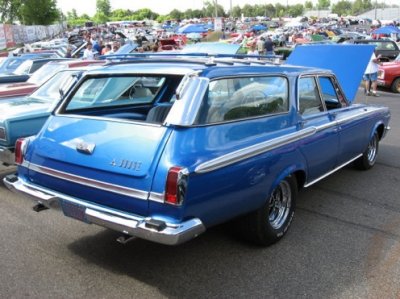

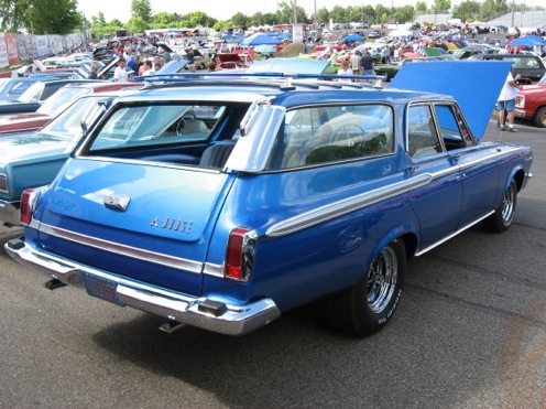

Did it to this 65 Coronet wagon, and all I had to do is take out the left side axle out of the rear end . Gas tank is on the left side of course, then she came out no problem.

Yes indeed...it seems that is all the extra clearance that is required. The guys at the body shop pulled it out before the wheel lip repair was done and now can't get it back in. I need to do some repairs on the fuel line and pick-up anyway so I'll tackle it later.
Nice looking wagon BTW Any chance you have a valance for a '63 that needs a new home?
