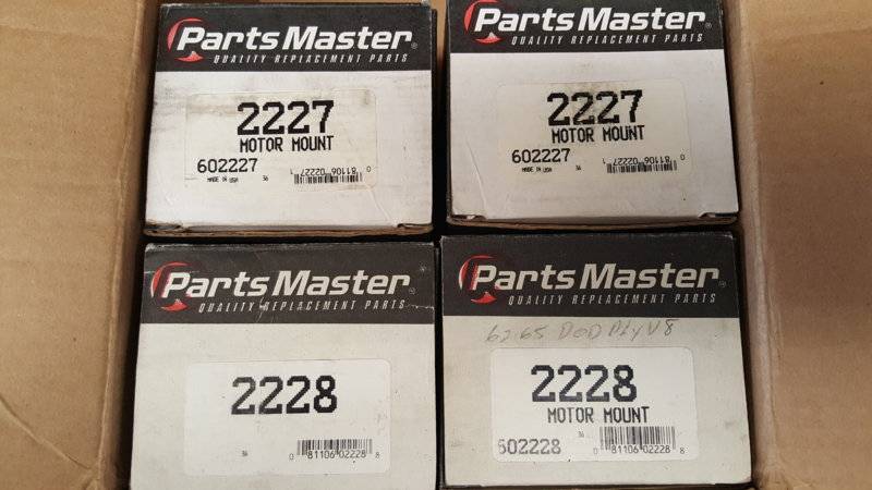

I found two sets of NOS on ebay. They're your best bet for longevity, made in usa.

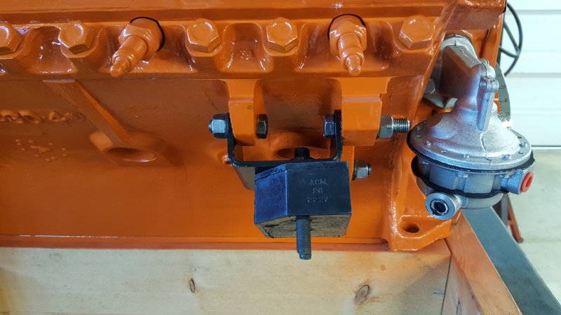

Here's the brackets off my '62 361, installed on my 440. Don't mix them up. (2228 driver's side)

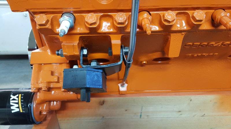

2227 passenger side
Sorry to resurrect an old thread but I have this exact same issue! Is that the proper way to install these mounts or are those rotated 180 degrees around the wrong way? Why is the driver side barely sitting on the mount?
The pics I posted are correct. Yep, looks weird but that's how those type look.
