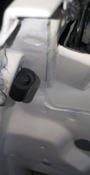

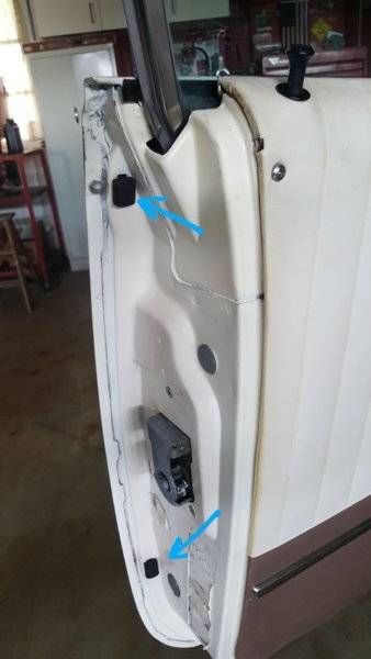

what door stop rubbers?explain what they are and why the passanger door doesnt have anything on it and it operates perfect
Here's what they look like...
https://www.ebay.com/itm/1964-Plymo...-Kit-New-MoPar-/371974885450?oid=371023556687
If you buy a complete rubber kit for the car, should have them in it.
Pretty sure, like on the 64, 63 is the same. Look for cut slots on each door, upper and lower, near the rear edge. The bumpers go there.
Why is the passenger door work perfect? My bet...bumpers are on the door, and you don't realize it. Without being able to see it...can't say!!
Are the latch and catch the same on both doors? Can you rotate the door latch by hand and hear the clicks as it turns? Is the nylon slide in the top of the door latch?
No bumpers on the door on the passanger side works perfectly,
