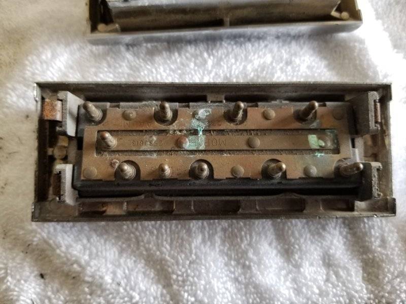

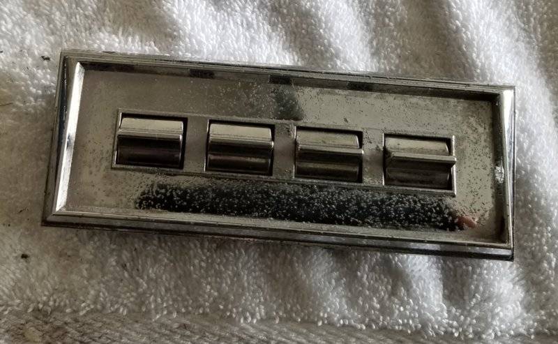

Any one recognize this power window switch ? It was in my 63 Ply. It has a different pin set than the ones I just bought . Oh Boy, Am I confused !!! Frustrated In Hawaii, C

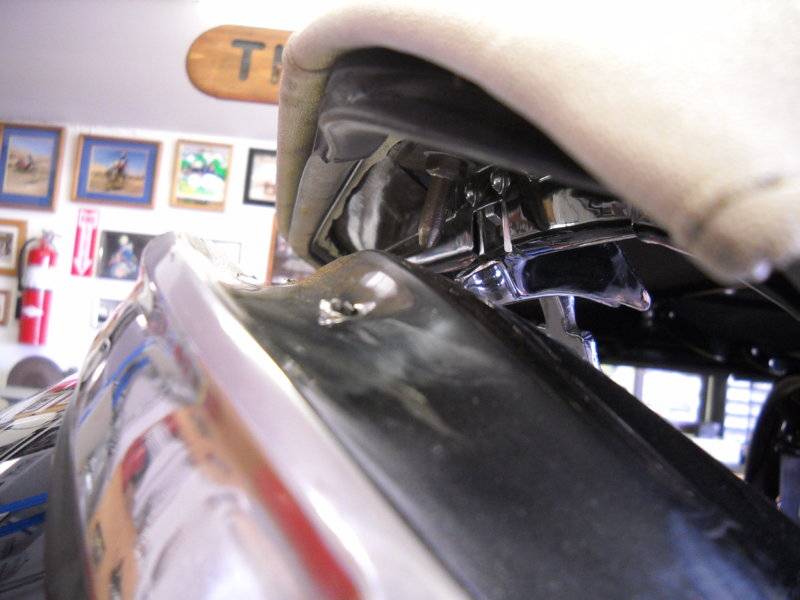

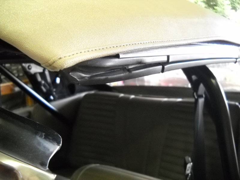

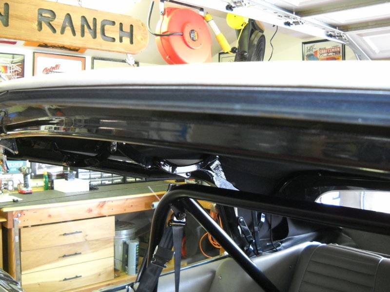

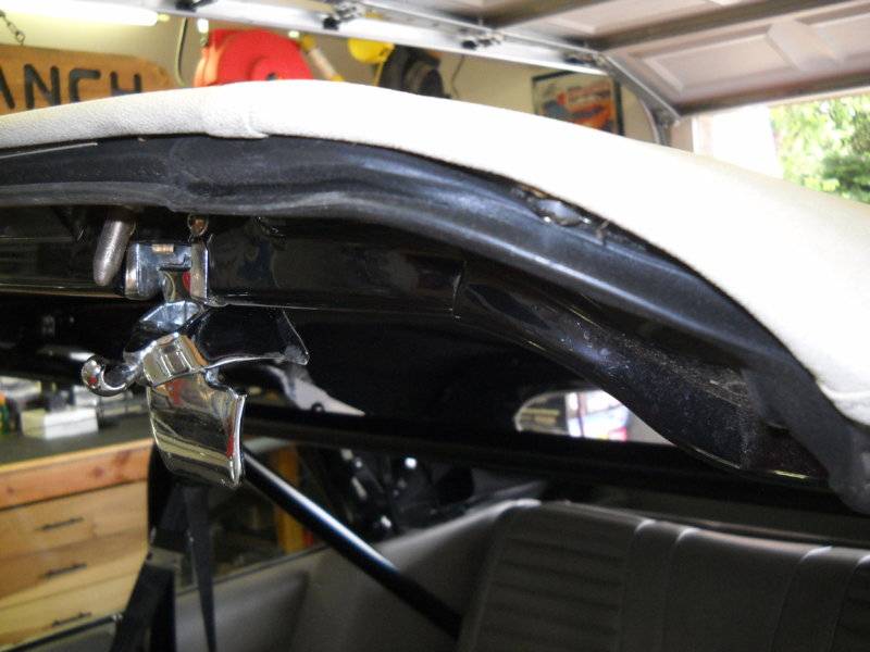

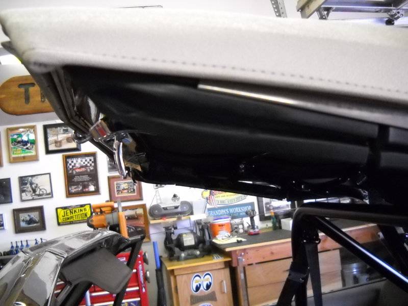

Here you go. Hope these help. The forward most retainer over the side glass is 19.25" long and extends 1.25" over the wing window.

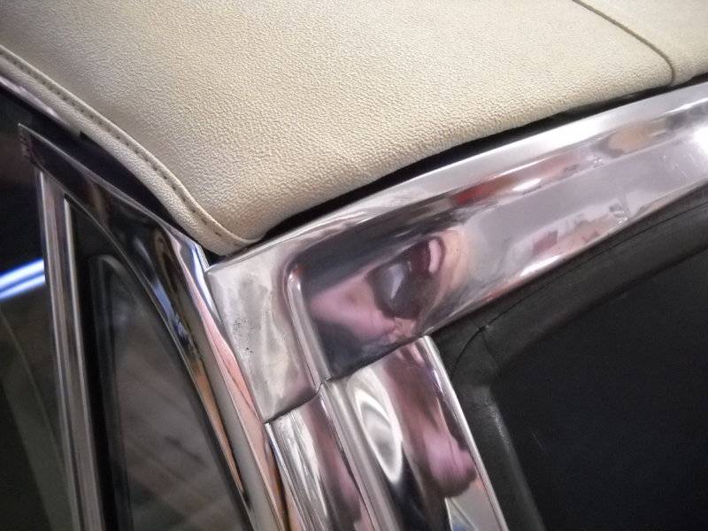

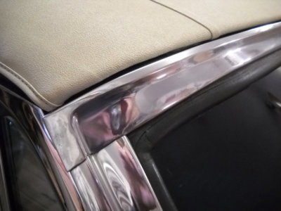

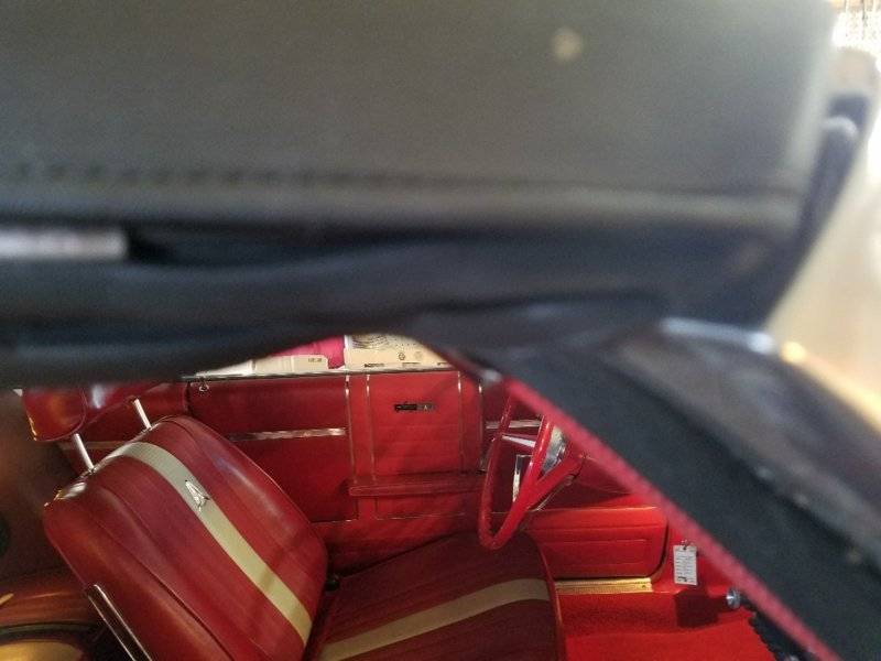

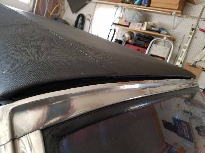

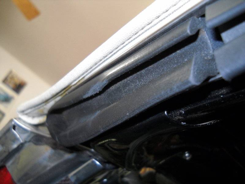

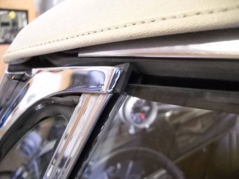

Hey thanks Colorado Dave. Yeah it's great weather here too near 80! Here are a couple pics of my top with the new header seal. The seal just hangs loose around the turns (over the vent windows and the first 1.5 inches over the windshield frame; there's nothing to retain the seal in place...no channeling to insert the seal. This must be stock design I suppose gotta just glue it; but seems kinda trashy to do that. And as it is there's a little daylight at the top of the vent window and side of windshield frame. When I put in the new door seals as they were before there's no sealing above that (picture showing door open and that seal). I always got rain water in those areas before all the top work (new top). I know the entire top frame likely needs adjusting and have a guy that's going to look at this but I'm afraid that makes no diff with how the corner supports exist. The old seal didn't look glued though it was really old.

Look at the second picture in the second row and the second picture in the fourth row. The header seal slips into the chrome strip over the door. Post a picture from the side, showing the door glass and the strip above the glass on your car.

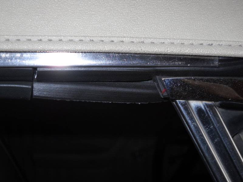

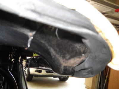

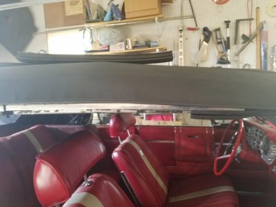

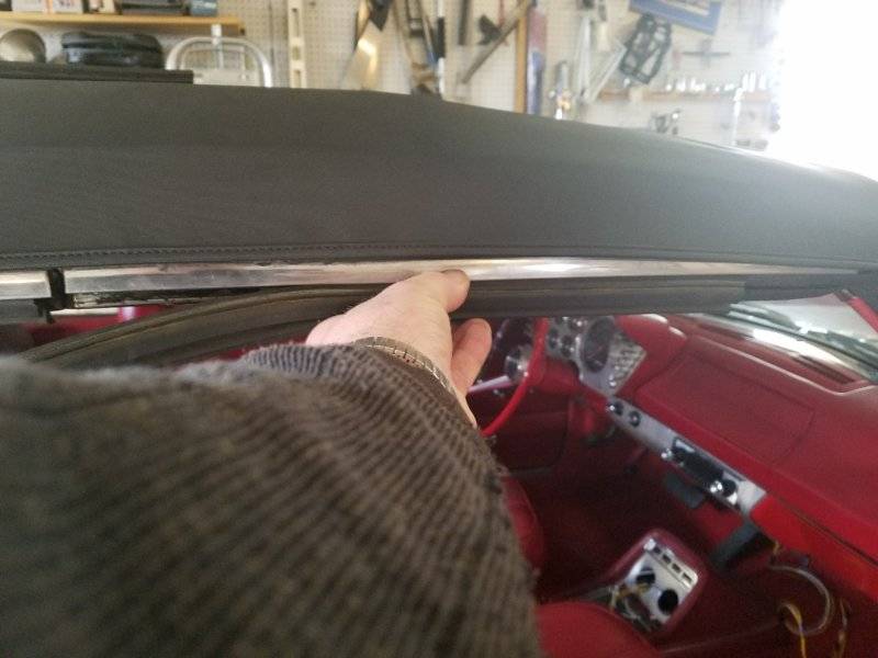

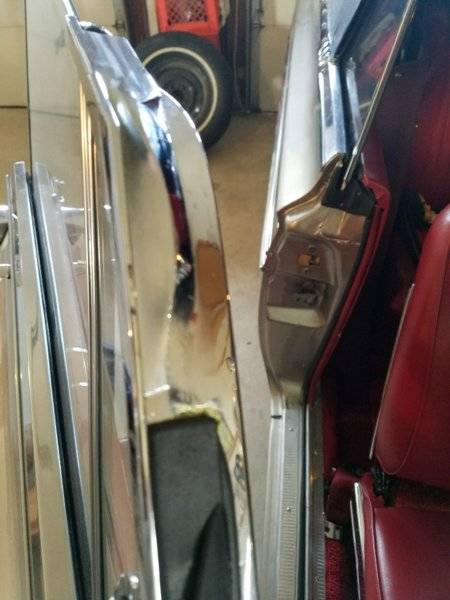

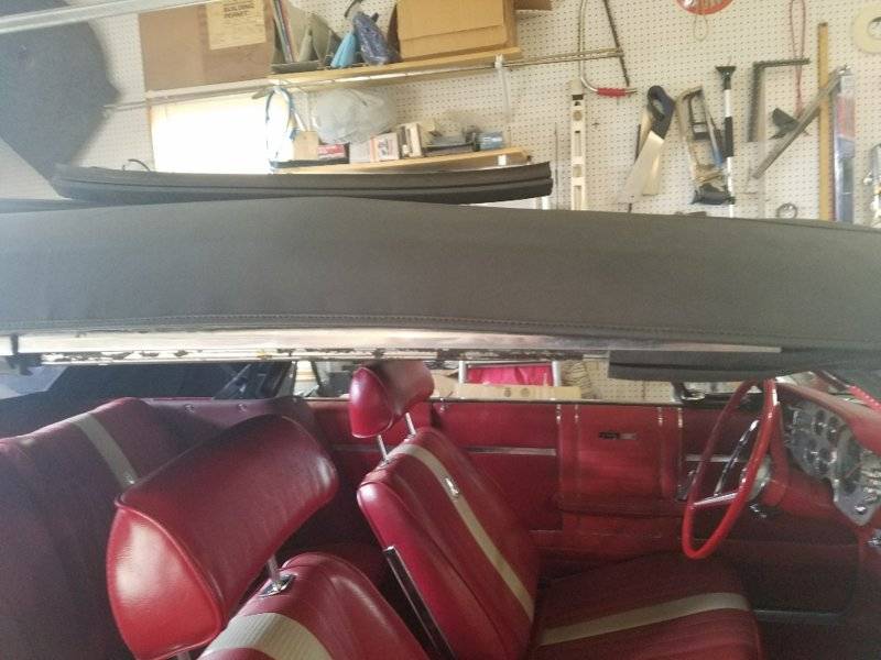

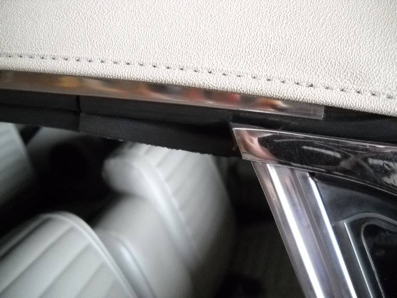

Colorado Dave here are two photos I think what you were wanting to see. I had taken out the seal above the door windows as the new seal is longer so one photo has me holding that seal up while taking a pic for reference. I would need to cut it to fit with the new seal as it's about 1.5" too long abutting to the new header seal. The channel to retain the header seal as in the other photo assume is the stock design (nothing missing) terminates above the vent window frame about 3.25" before taking the corner over the windshield. So it's that area where there's nothing to hold the seal unless gluing up that area. The other issue as I think I mentioned is the new seal at the corners has less girth than the old one. Another member suggested using some cut rubber hose to insert here to beef it up considering the thinner aftermarket seal. Thanks!

Check these two pictures out. The header seal bends around toward the rear and inserts INTO the stainless trim over the side and wing glass. It is glued with 3M Super Weatherstrip Adhesive but the trim is what locates it. You can then trim the seal over the side glass to butt into the header seal.
Check these two pictures out. The header seal bends around toward the rear and inserts INTO the stainless trim over the side and wing glass. It is glued with 3M Super Weatherstrip Adhesive but the trim is what locates it. You can then trim the seal over the side glass to butt into the header seal.View attachment 602437 View attachment 602438
Yours looks pretty much identical to mine and go figure...it should being the same car! Yeah the mystery for me was the appropriate securing of the corners of the header seal as they just flop loose between the gap on the side channels until it reaches around to the channel over the windshield frame. Since the aftermarket seal is less fat (at corners) than the old one, gluing it seems to present a hassle of it seating too far in that could create a poor seal. I'll play with it and maybe see if the other member's tip might work out to add some beef too. Hey thanks much for your help!

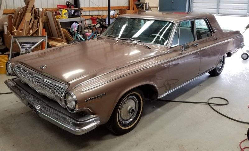

New to the forum. Just inherited my grandparents '63 Polara 4-door this last winter. Spent some time getting the 318 poly V8 back to running form as it hadn't been driven in 2 decades. New fuel tank, sending unit, fuel lines, brake components all around. Last night was the first time I've taken my family out on a Sunday drive (ice cream!).
