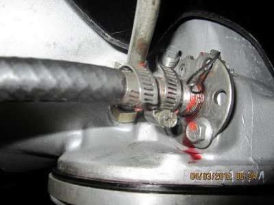

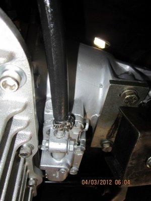

Because they are known to leak where it goes in,I slid the cable into some fuel line so it butts up against the entrance and put a hose clamp on it.Fluid can travel up the cable several feet,,,,,
I use shrink tube over the metal clamped fittings of the cable. Slide it on, heat it up, done.
Doug
Next time my cables are out,I just might switch to the shrink tube!!
I use 3m weatherstrip adhesive under the shrink wrap before heating it, cleaned with brake cleaner first. Has sealed my cracked end solid!
