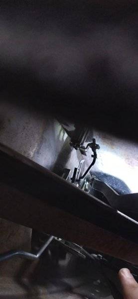

Yes, I have a FSM and I popped the door lock out and the part # (if you want to call it that) is the same as the passenger side door. So on the door lock itself there are (2) holes in the lever that the locking rod attaches to. Initially I had the locking lever rod in the hole at the end of the lever. I moved the rod into the hole closer to the pivot point and no difference, I can still push the outside button and unlock the door. Here is a pic of what I am working on. Now I did unhook the handle to lock link lever for clarity purposes. I can't believe this is kicking my rear.
