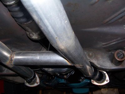

I'm running (on my '63 b-body) THE original B/W T10,
(no 833's in 1963)
with the ball and trunnion....426 1 4bbl, 355 rear.
no problems here..
here is a peek.....:3gears:
sonny
