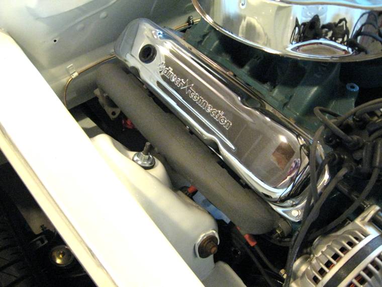

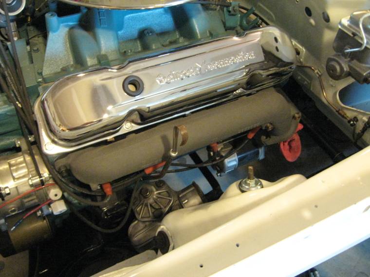

These are the correct '64 B/RB exhaust manifolds.
68 & later B-body H-P manifolds will work for you, Little better flow! If you use them? I'd suggest removing the heat riser plug the hole or weld it up! Those things always rattle! And they are a little close to the inner fender well.
You can't see it in my picture, but that's exactly what I did.
