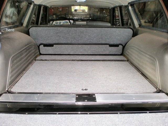

What do you mean. There's another switch to control it other than dash and rear key slot?
Inside top left rear wheel house.
