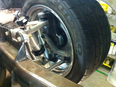

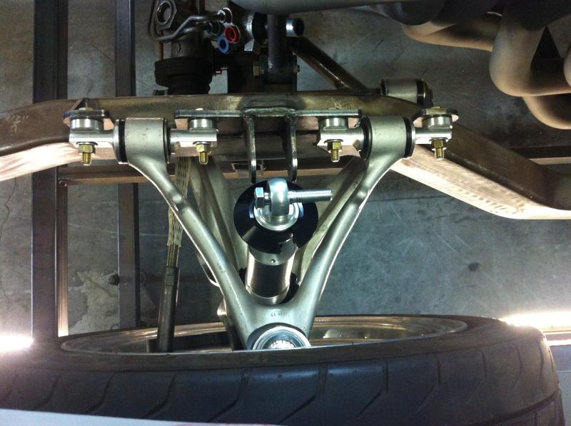

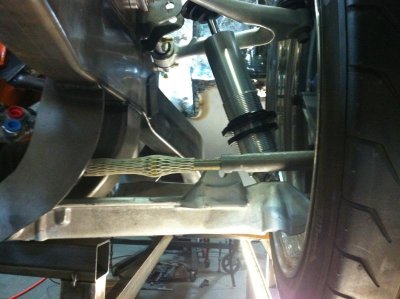

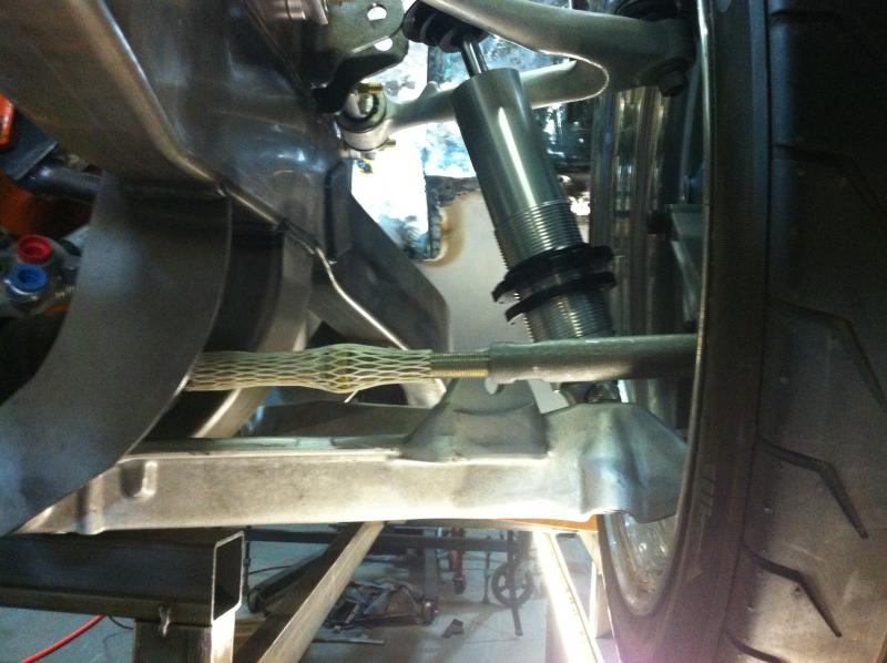

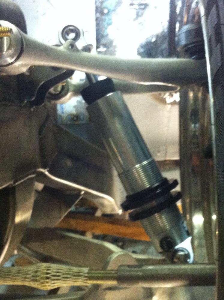

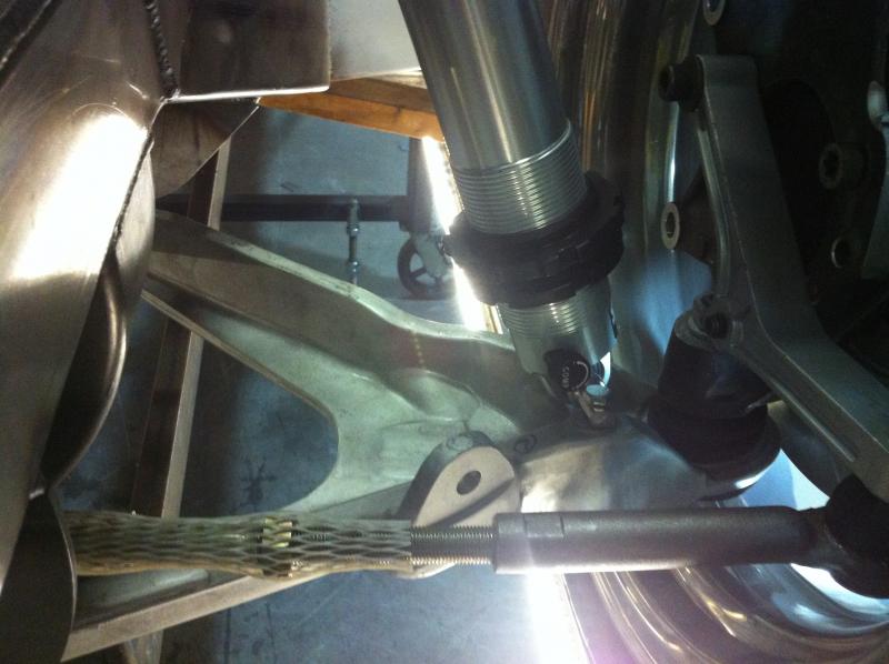

While I've got a few minutes of free time I wanted to upload the suspension pix I mentioned in last nights post, so here ya go:
dam nice job there carnalsupply this is shaping up nicely cant wait to see more
Thanks much Joe; coming from you that means a lot!

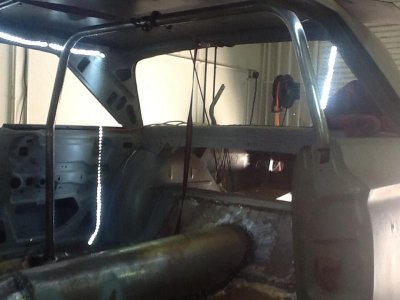

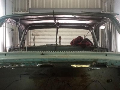

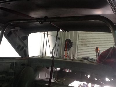

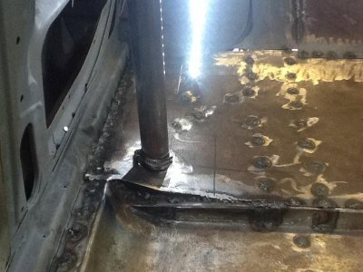

Here are a couple pix of the roll bar mocked into place:
To get the roll bar in place I cut a hole in the floor at the base of each leg, dropped the bar through the holes, lifted the bar vertically into position, blocked it from underneath, then strpped it so the legs are perfectly vertical. I'll cut the legs to length, trim them to fit the floor, then weld them and the base plates to the floor.

Shaping up nicely! I really like that front suspension, looks really nice and neat.
Thanks 7! I'm really hoping the truck arm rear suspension, coupled with the Vette front, will make for a supple but well handling car.

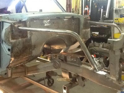

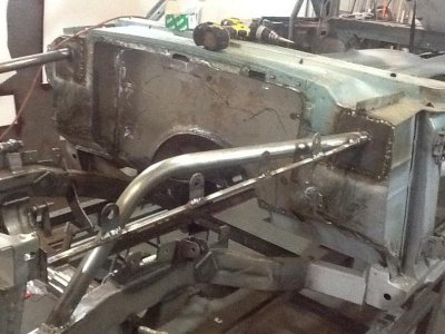

Been quiet on the forum but I have been working on the Fury so here are some updates.

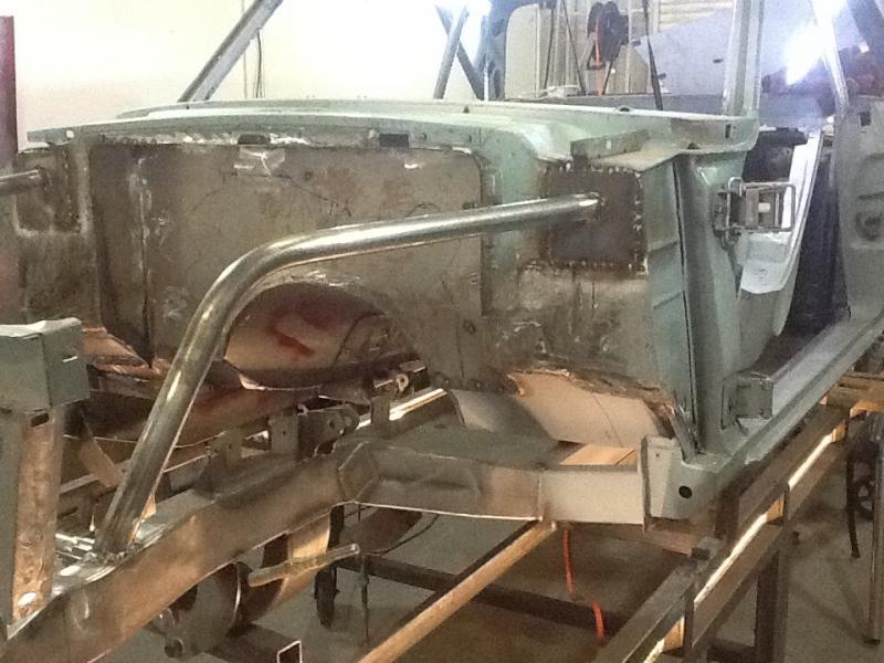

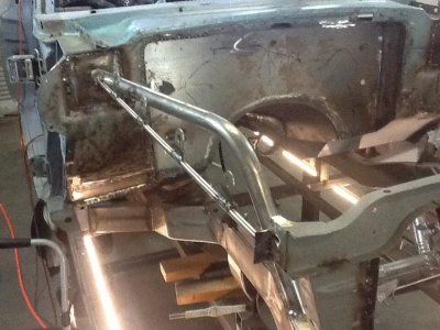

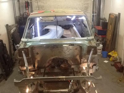

After getting the roll-bar location dialed in I moved on to the front down bars and fender supports. The down bars were actually pretty easy since there were no fenders to get in the way.
Once the down bars were in place I re-mounted the fenders (loosely) and laid out where I wanted the fender supports to go. One important consideration was tying the supports into the rad support to stiffen it up (front to rear) and I got lucky, the bottom edge of the fender (with the mounting holes) was close to the down bars but with no interference..
Once I got the support tubing (3/8" od thin wall) tacked into place I loosely mounted the tabs, then tacked them in place.

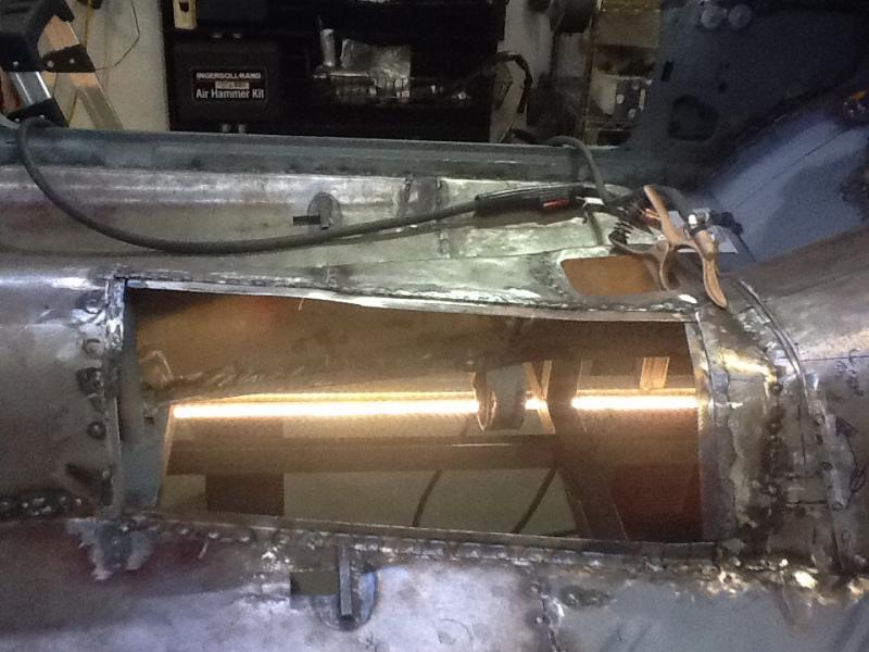

I'm waiting for more roll-bar mounting plates to arrive so I decided to cut out and replace a section of the trans tunnel I was unhappy with. Not sure how I fabbed up such an ugly POS the first time around but it's bothered me ever since I finished it so I knew I had to redo it. Here's a shot of the tunnel after I cut out the ugliness and added a flange around the perimeter; tomoorow I'll fab the new patch and install it.

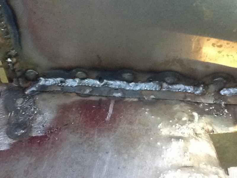

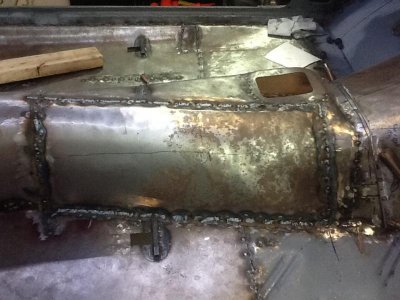

Today was a GREAT day in the shop. I got the patch panel for the trans tunnel fabbed and installed with no issues whatsoever and had an epiphany of sorts; wearing my reading glasses under my welding helmet makes an AMAZING difference in the quality of my welds. Yea, sounds obvious but other than reading or doing things really close up I don't need them, or so I thought.
Here's a picture of the finished tunnel and a closeup of the beads I'm actually capable of running (not perfect but FAR better than anything I've been able to lay down lately):
Tomorrow it's back to the shop to weld in the front of the trans tunnel over the bell housing.

are you using 023 wire on the sheet metal welds
I don't know what brand of welding helmet you have but the outer plastic lenses in most can be changed out to a magnifier . I have 1.5 magnification on the outer lens of one of my helmets that I use for close up work.
Hey Steve,
I've never heard of such a thing; thanks MUCH!
I'm using a Kobalt so I'll look into it.
