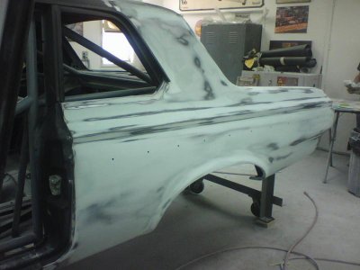

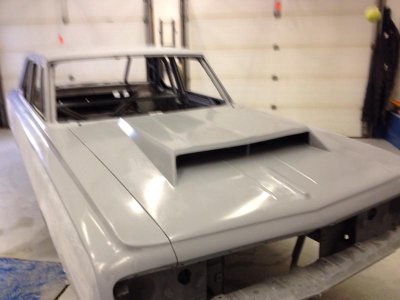

Thanks Bob, my project is coming along. Blocking is now done and 1 more day of 400 wet sand and it can all come apart and go back on the rotisserie for paint.

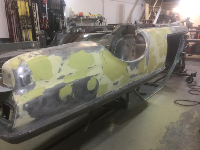

I'll get a finished shot or two tomorrow but for now here's a shot with the last dabs of filler covering some pinholes and minor low spots:
Spent another day at the shop putting on filler and taking it off, but believe it or not I think I actually finished the filler on the driver side. On to the passenger side!
Here's a shot of the finished (less priming and blocking) driver side:

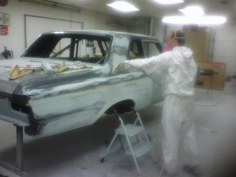

We always skim coat. Filler is cheaper and less brittle than primer. Also use very long blocks on flat panels 2-3'. Here's my buddy Ted doing the deed on my 64.
Doug
Sounds like your in good hands! Agreed Prop, I usually get all pumped up to get the bodywork started but after a couple weekends it becomes a dreaded choir but a necessary one. I would farm this step out in a heart beat if I could afford to.
It hasn't taken me long to see/experience EXACTLY what you mean; this is some tedious, tough stuff to do.
Doug
Thanks Doug, it sounds like I'm on the right track.

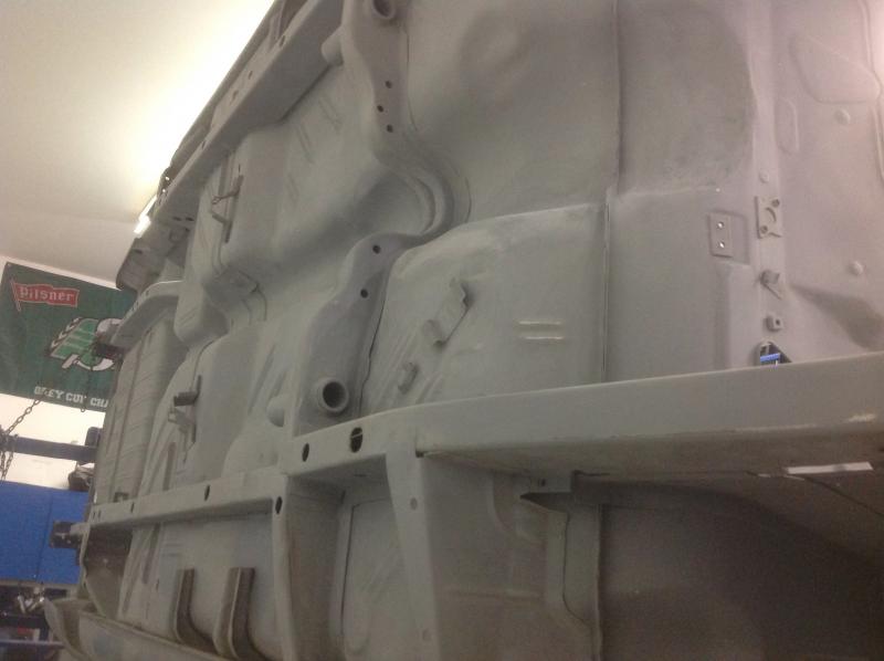

Man isn't that the truth. It's always exciting starting the next step but it fades in a hurry.. I've spent the last 2 days sanding the primer on the bottom of my 64. Tomorrow should wrap it up though.. image.jpg
I use adhesive roll paper 220/320 and get as much as I can. It is a good quality paper and it is easy to hang onto when it is folded and stuck together. I will use Scotch Brite pads where I need to. It's a tough go on the fingers but it's got to be done.
I'll finish up the engine bay tomorrow and then break out the 400 wet sand. I'd rather be doing the underside and engine bay over that damn trunk anyday. That was an ugly job!

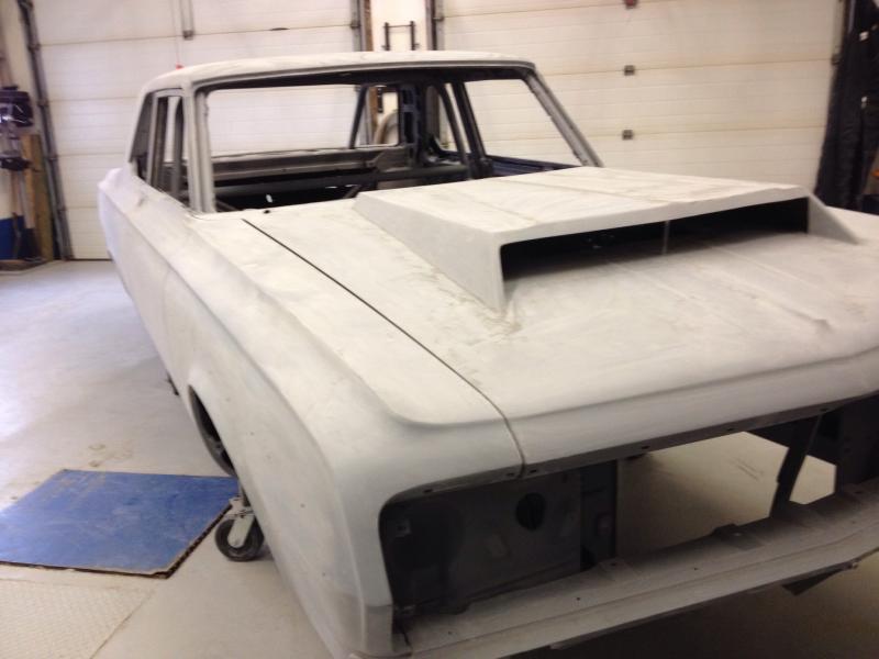

Bob I also replied to your hood scoop question the other day.
My buddy Ted and I switch off. He does the paint and blocking. I do the engines, trans, wiring, suspension, etc. We both weld panels. I get to do the inside of the trunk, engine compartment, door jambs, under chassis, all the fun stuff.
Doug
