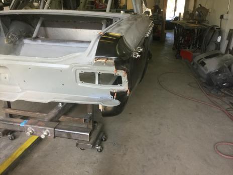

Late last week I got the "all-clear" from my doctor so after nearly 4 months I actually got back in the shop today; I can't believe it's been so long!

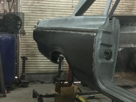

I spent the day repairing one of the rotisserie mounts that had cracked then got down to fitting the quarter panel. The most frightening part of the job was lining up and cutting the horizontal cut just below the body line, but I pulled on my big-boy pants, marked the cut-line, and plunged in. Below are some shots of the panel in place.
One area that differs from stock, and therefore will need some massaging, will be the wheel lip. If you look back on the previous page you'll see how I "de-humped" the wheel well and this definitely affected the outer lip of the wheel well. No big deal when compared to other stuff I've had to do.

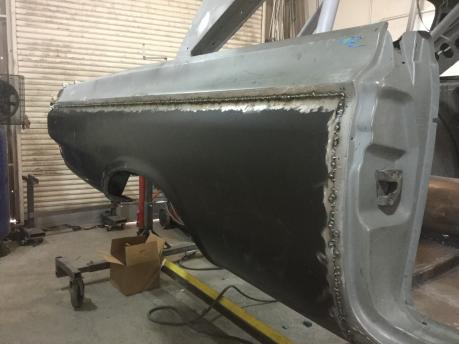

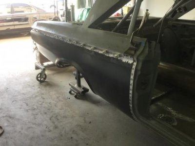

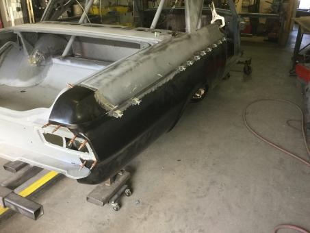

WooooHoooo, what a weekend; I got the quarter panel completely installed! I still have to clean up all the welds but that shouldn't be too bad, then after that I'll finish off the body work.
Here are some shots of the install:

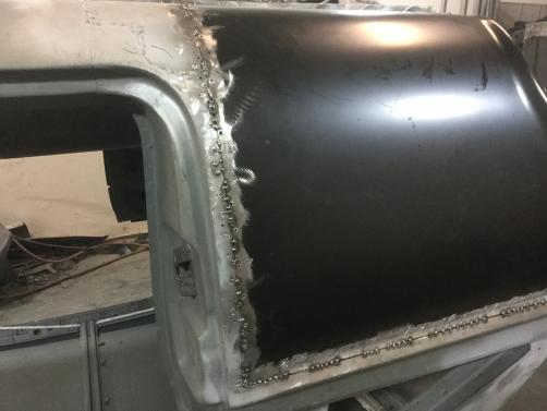

Spot weld, after spot weld, after spot weld. I used a couple dozen panel alignment clips to keep the new quarter lined up with the existing metal. Thees things are really inexpensive but they sure do a great job.

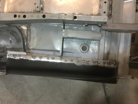

On the lower quarter behind the wheel well I used my spot welder. It was tough controlling the welder, I got some burn through, but the welds are strong and I'm pleased with the results.

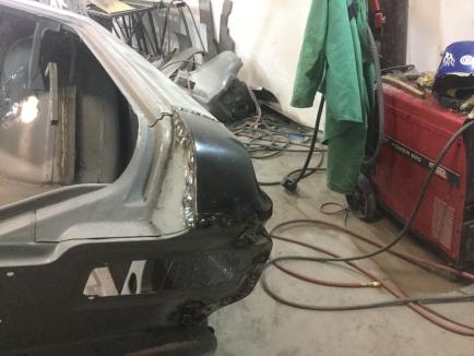

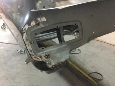

Below is the tail light area, which in some areas has 4 layers of metal layered/sandwiched; this was one of the most difficult areas to work on, first delaminating the old metal then trying to fit the new.

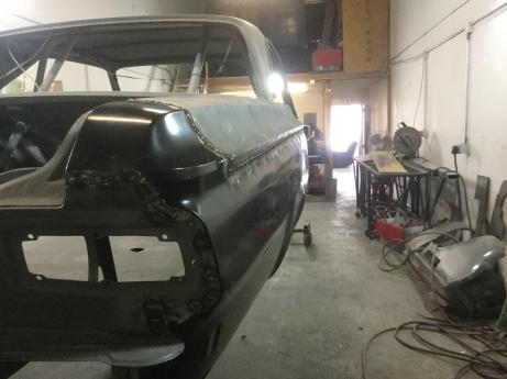

Here's a shot of the quarter after a couple hours worth of spot welding:

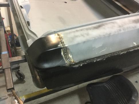

I didn't want to disturb where the quarter panel meets the "C" pillar or the front trunk corner, that's why I blended the quarter panel below the body line, but doing so also forced me to blend the corner above the tail light. This was one of the areas that took the most time to fit correctly but the results were really worth it.

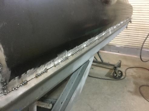

I wanted and planned on using my spot welder on this flange but just couldn't get the arms to fit so I ended up fill-welding the flange and will grind them down along with the thoosands of tack welds:
With so much area to weld it was pretty easy to get good results with no warping, so the body work should go pretty quickly (after all the wonderful grinding!):
