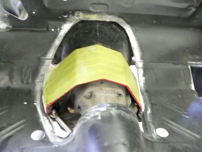

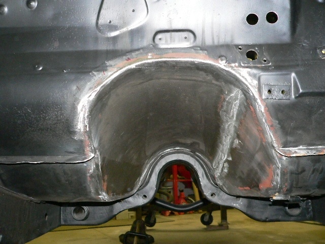

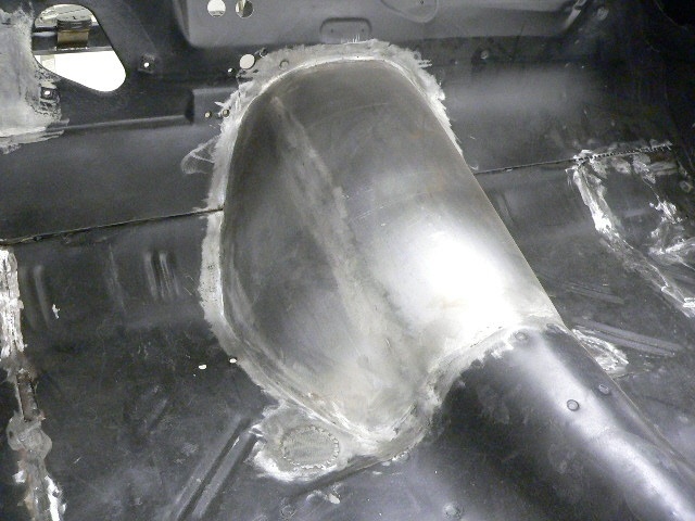

If your going to run a shield cut the floor now. You'll be much happier you did later.

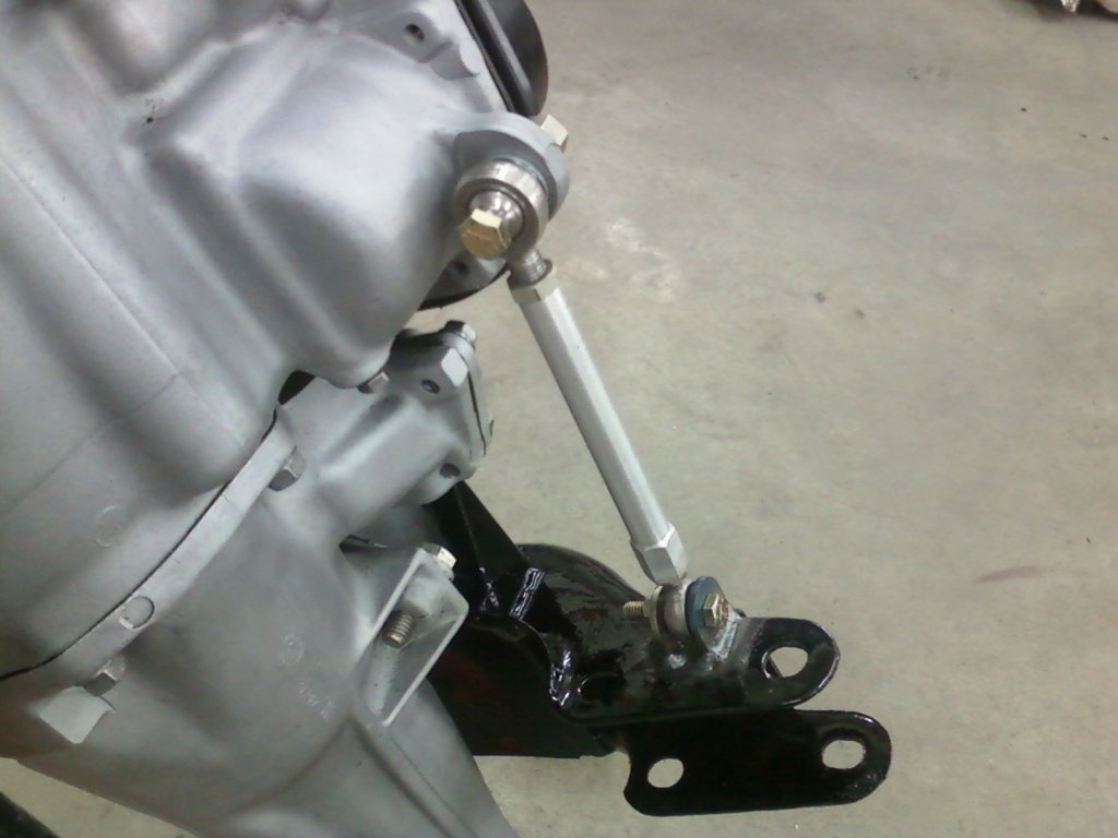

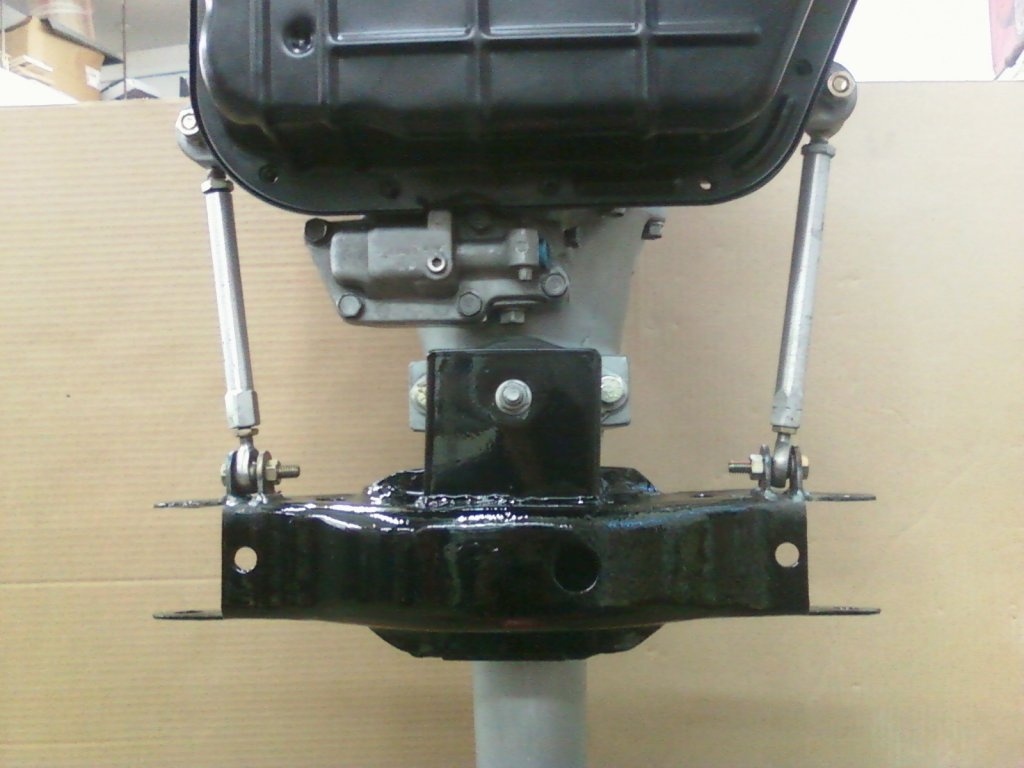

I see you are using a 64/65 transmission, but what is the idea behind the extra side braces?
They limit the fore/aft movement of the motor which is mounted on motor plate. Poor strength front to rear with a large flat piece of metal.
