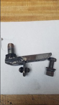

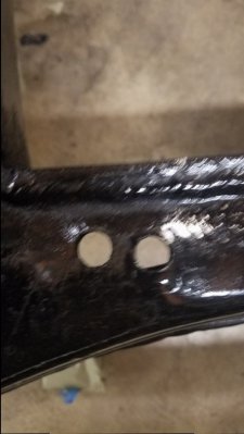

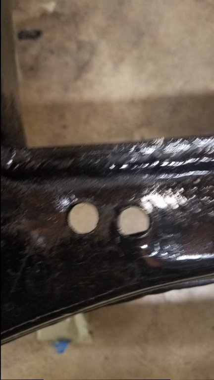

Here's the engine limiter I use in my N/SS car! I have a modified /6 k member! A pretty simple setup but works fine! The pin slides into the boss on the lower corner of the block,And is bolted to the k member with a1/2" and a 5/16" bolt. I had to move the engine over when I went to a bigger header you only need one hole!Going the NSS route. Would like to keep it somewhat streetable, just in case.
